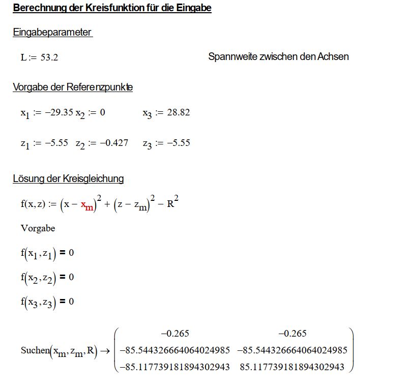

Im trying convert this mathcad solver to smath but it doesnt work.
Radius_318a.sm (9,34 КиБ) скачан 1174 раз(а).

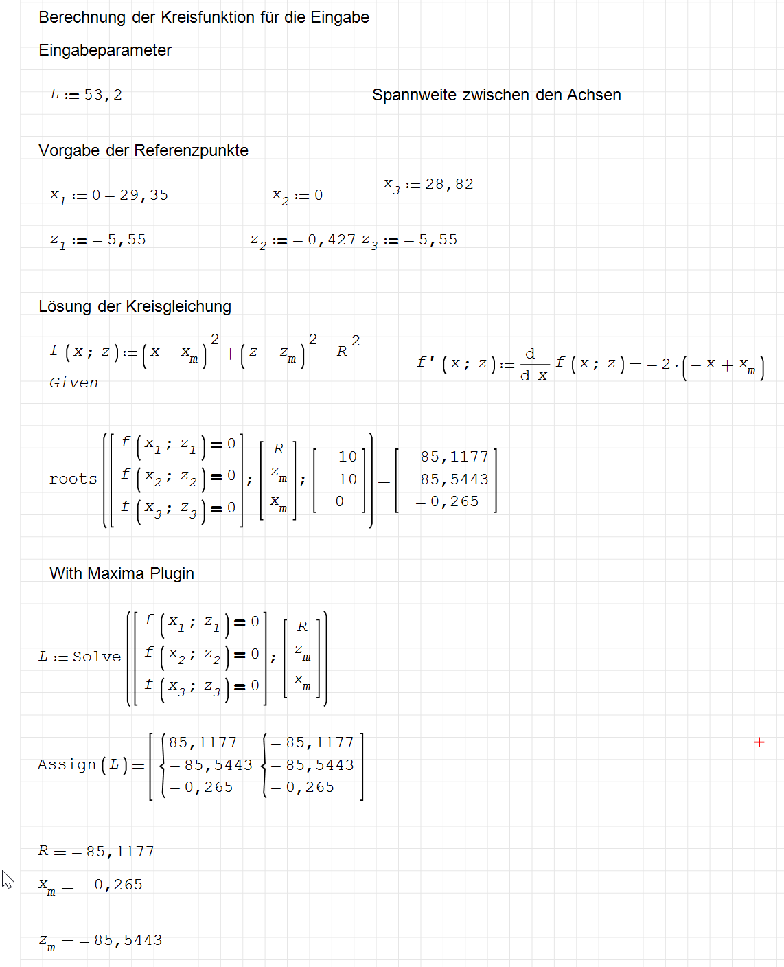

It is a non-linear system. With the internal "Roots" solver it is appropriate to use initial values ​​sufficiently close to the result.
You can use some of the smath plugins that are more robust. For example, with "Solve" of the "Maxima plugin you get the result.
Показать спойлер
Radius_318a_ser.sm (337,14 КиБ) скачан 1246 раз(а).

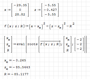

With an addition to sergio's solution;
You can use vectors while solving.

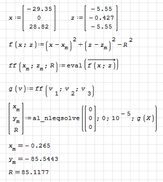

Solution with another solver.
al_nleqsolve.sm (6,99 КиБ) скачан 1136 раз(а).
