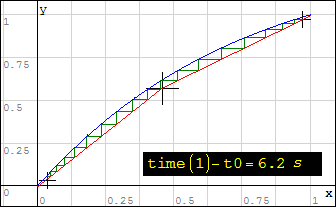

WroteIs it possible to use this method to approximate a function like the one in the picture?
If you have it working in Smath, please attach the document.

I have attempted to construct your picture.
It produces a graph. I see no way to reduce further whereas
it is not simply numerical. If you leave it this way, then
it will track the parameters [R0, Lo, k, a] which are
presumed resulting from previous calculations.
Does it help ? ... Jean
Unknown CF.sm (26,58 КиБ) скачан 1416 раз(а).

... at this point, your continued fraction if numerical
can be reduced to J_Fraction of substantial visibility.
You will have to carry the manual procedure for each
numerical valued system ... observe the β construction
Please give news ... Jean
Thiele UNKNOWN parametric [4].sm (50,45 КиБ) скачан 1233 раз(а).
