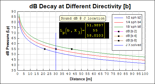

#2 Опубликовано: 30.04.2023 18:18:45
I can work with dB in Mathcad 15. How to work with dB in SMath ?
Simple example attached.
Cheers ... Jean.
Inst_dB Sound Copy.sm (142,11 КиБ) скачан 1350 раз(а).

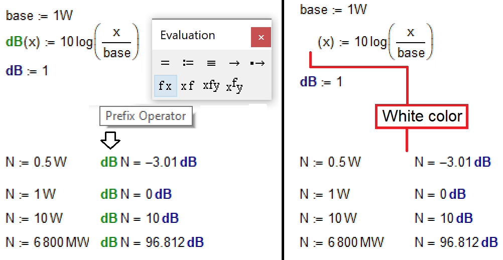

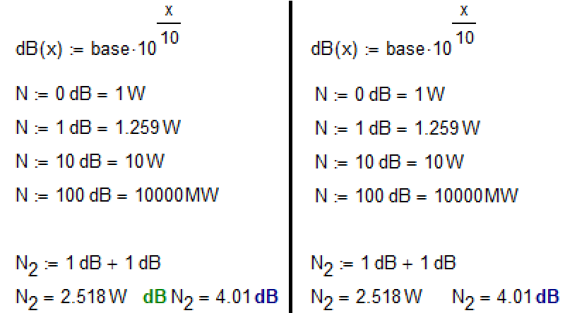

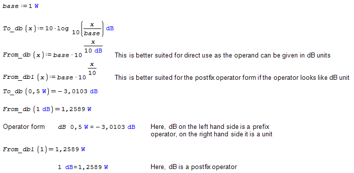

#3 Опубликовано: 30.04.2023 19:05:14
If Davide could provide operator forms for To_dB() and From_dB() then this could pretty much look like in Mathcad.
dB.sm (9,61 КиБ) скачан 1283 раз(а).

Thanks,
but how can I see your plot without any formatting?
Thanks,
But how can I use the postfix and prefix operators in SMath? Is there a tree operator too?

but how can I see your plot without any formatting ?
Try to zoom your document in native Smath 100 %

#8 Опубликовано: 01.05.2023 16:02:21
Thanks,
Davide Carpi has defined operator representations for some functions in his Custom Glyphs plugin. So he is the wizard who can make that happen if you convince him. He also implemented the Glyph for the Maxima().
The drawback is that users can easily read these expressions but it is hard to guess how to write these operators if you aren't aware of the background function used for it. So the best would be to have a side panel (as it is implemented for the currency units plugin).

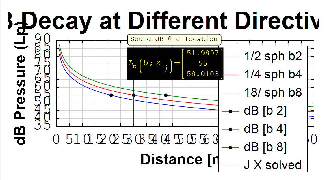

Sorry, but same result.
#10 Опубликовано: 01.05.2023 18:15:19
Seems something related to DPI scaling in the plugin. Just a guess.
#11 Опубликовано: 01.05.2023 19:20:47
Originally Posted by: Jean Giraud [/url]Originally Posted by: OchkovVF [url=/forum/yaf_postsm81092_dB.aspx#post81092]but how can I see your plot without any formatting ?
Rewrite the code on your system.
