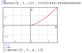

You can slide any decoration over a variable name
... or over a function definition ... even an arrow !

You can have some circomflex hat as well from Charmap.
All or most Charmap can bear function name, even single arrow.
Take care Basile ... old Collab ... Jean.

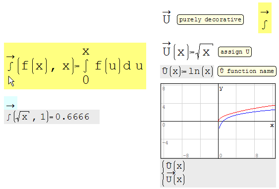

... the document for eventual projects.
Cheers ... Jean.
Maths Symbols DECORATION Copy.sm (17,26 КиБ) скачан 1359 раз(а).

#12 Опубликовано: 08.05.2023 08:33:43
You can have 'arrow(s)' as variable name
Take care Basile ... Jean.
BasileArrow.sm (28,75 КиБ) скачан 1395 раз(а).
