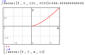

#7 Posted: 5/6/2023 11:47:36 AM
Asked a long time ago.
Unfortunately no possibility found so far to set vector arrows
over letters.Only over printed documents
You can slide any decoration over a variable name
... or over a function definition ... even an arrow !

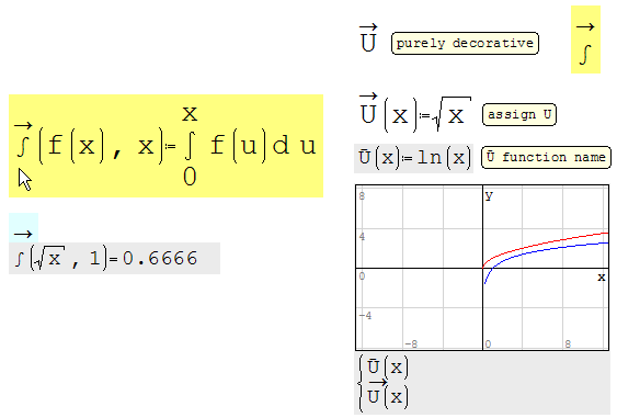

#8 Posted: 5/7/2023 12:42:38 AM
Basile
Basile
8 likes in 172 posts.
Hello Jean,
How do you enter the arrow, Hat, etc. above such that the two are together and move together?
Basile
#9 Posted: 5/7/2023 9:42:47 AM
Hello Jean,
Basile
You can have some circomflex hat as well from Charmap.
All or most Charmap can bear function name, even single arrow.
Take care Basile ... old Collab ... Jean.
