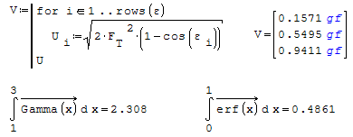

In Smath, two of the builtin functions needs be
integrate/vectorized ... if not: "x not defined".
Thank you Jean for supplementary explanation, but I'm not sure I got it clearly. Do you mean that if the expression includes more than one built-in function, as in your snippet (cos,sqrt), than it should be vectorized either as in previous example in this thread, or using the loop, as in your snippet? Could you please share some sources from which I could obtain in-depth description of this concept in order to save your time?
The for loop will take any length and export ... simply !
The previous vectorize is a display only. Same not same for end use.
More vector maths attached ... not updated for 6 years.
Cheers, enjoy Smath ... Jean.
Welcome to Smath Community.
2 more undefined 'x' complains.
1. Smath Simpson does not recognize the Power Function X^Y
2. Does not recognize Lamvert W(x)
Cheers ... Jean.

You give gf
The for loop returns gf
In most applications you vectorize over sqrt
Some applications needs vectorize inside sqrt and over sqrt
Cheers ... Jean.
