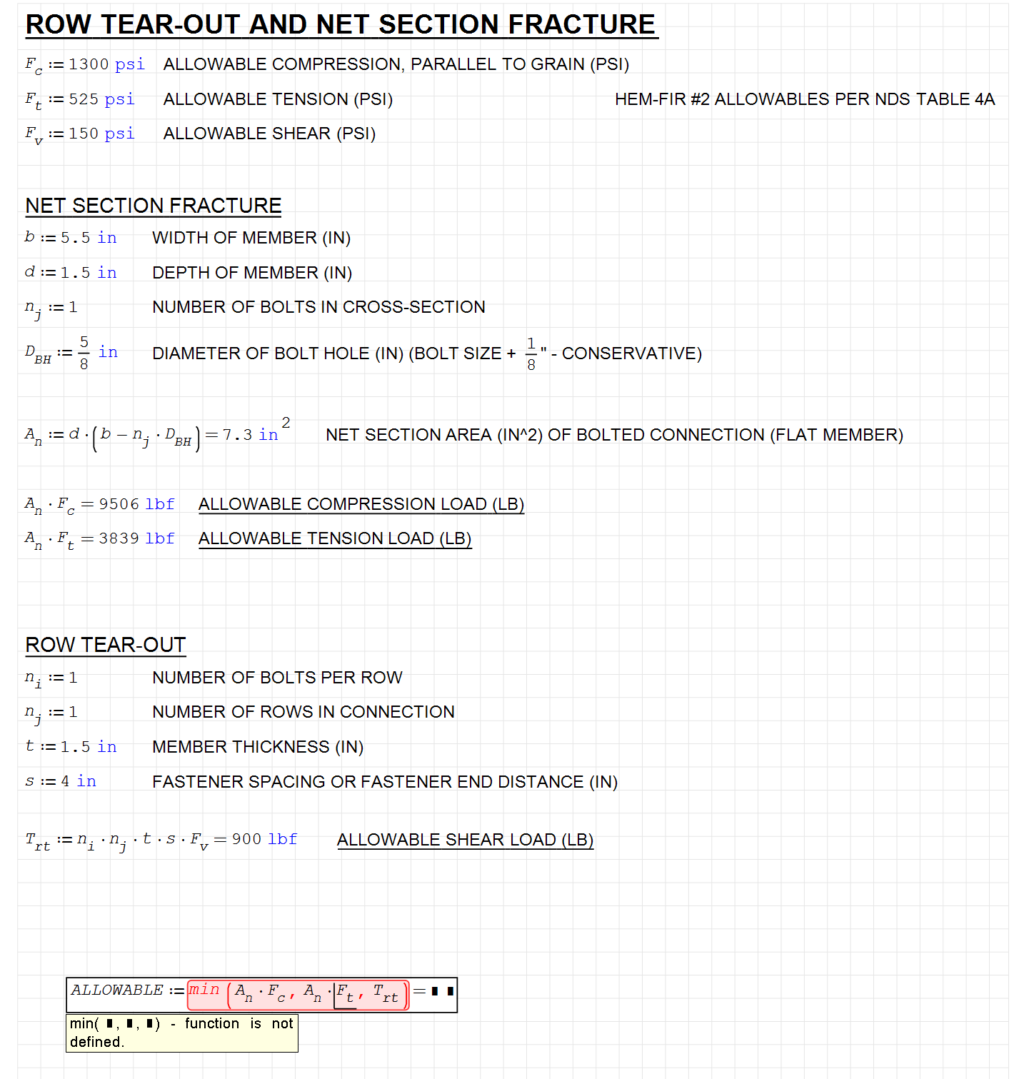

I'm struggling with the 'min' function. Could someone please point out where I'm going wrong? Thank you.

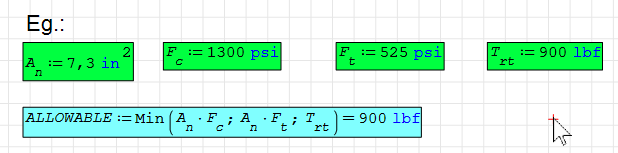

Hi nominal_diameter,
Try this way:

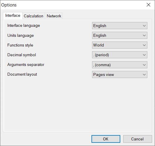

The semicolon or comma is just the default separator for the list of values, set in the Tools menu under Options.

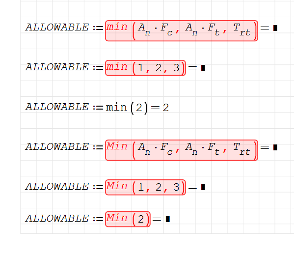

I've tried using the Min function and still get the same result. I also tried entering a string of numbers to see if that would work, but no luck yet.

On both Min and min, the baloon says function is not defined.
