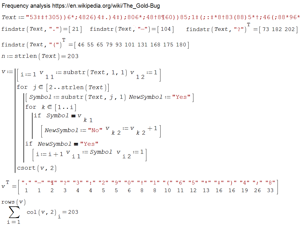

#1 Опубликовано: 19.10.2023 17:44:00
Valery Ochkov
Valery Ochkov
Gold-Bug.sm (80,3 КиБ) скачан 1431 раз(а).
#2 Опубликовано: 19.10.2023 18:56:08
Gerry_Bush
Gerry_Bush
12 сообщений из 14 понравились пользователям.
One issue is that the if statements should be under separate Line arguments, |.
However, correcting that gives a different output to the example so there may be other issues.
Gold-Bug_updated.sm (81,64 КиБ) скачан 1483 раз(а).

#3 Опубликовано: 19.10.2023 21:11:41
Arie
Arie
What is the text string used in the Mathcad File? I can see in the Text string in SMath that no "]" character exists. So I would not expect to have the same result as the Mathcad screenshot.
Valery Ochkov 19.10.2023 21:30:00
#4 Опубликовано: 19.10.2023 21:29:29
Valery Ochkov
Valery Ochkov
Thanks to all!
Gold-Bug.sm (12,78 КиБ) скачан 1459 раз(а).
