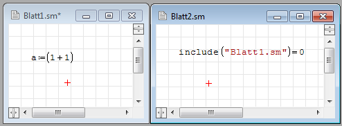

I am finally able to create a minimal example that reproduces the bug, see attachment. Include() seems not to work with brackets.
#51 Опубликовано: 28.10.2014 07:10:24
Updated. Bug fixed. Brackets now supported.

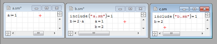

I would like to use cascading dependencies. See the attached example. In file c.sm I cannot access all the variables I have in b.sm. Nevertheless I have the influence of a.sm in c.sm through the variable b. This is strange to me. Is it a wanted behavior? Why?
Of course I could include a.sm in c.sm again. But I could also include another file d.sm in c.sm which contains a:=2. I would then end up with a=2 and b=2 despite b being defined as 2*a...
I think there are two ways of implementing this properly:
  1. You can acess all the variables like a class. I.e c:=include( "a.sm" ) ... c.a=1
  2. Or the variables are universally accessible in all files directly, resulting in a=1 in c.sm
#54 Опубликовано: 30.10.2014 06:46:53
There is a log file in the folder with the plugin (it appears if the function doesn't work.). The function can't find the file in the specified path. As for the rest - it's strange behavior. I'll see what's wrong.
#55 Опубликовано: 30.10.2014 13:01:46
Updated. Fixed bug with cascading dependencies.

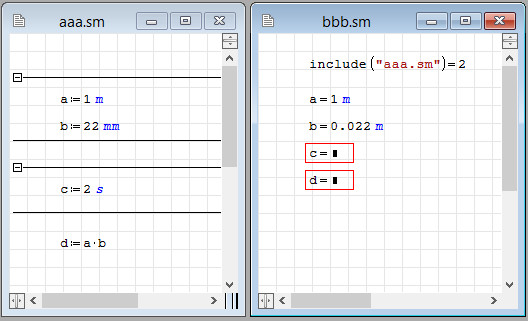

It looks like there is a bug if you include Areas in the source file.
If your data is included in more than 2 Areas, the plugin will send only the content of the first one.
#58 Опубликовано: 01.12.2014 13:26:53
I think this is not only my bug. I ask Andrey about it.
#59 Опубликовано: 07.12.2014 14:15:07
We found the problem. This issue is related to saving the file. Andrey will make the correction in the next build.
