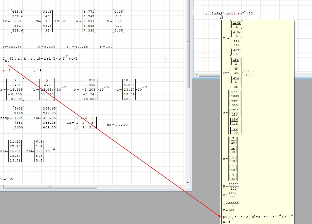

I was just playing bit with include(). I just figured out that the hoovering over the include there will be presented the alphabetical order of variables, the variables with dot in its name will be ignored. As I could understand only the assignment of variables will work - but not always (complicated structures will be ignored). Now, there is a bit of problem to kepp the track about which variables have been defined with include(). Maybe a list of them to be available?
EDIT: Hmm...uni posted this a minute before I posted this one. I will check function definitions - it did not work for me.
EDIT1: It is working regarding functions, but the dot in the names is still ignored. Variables are not now in the alphabetical order

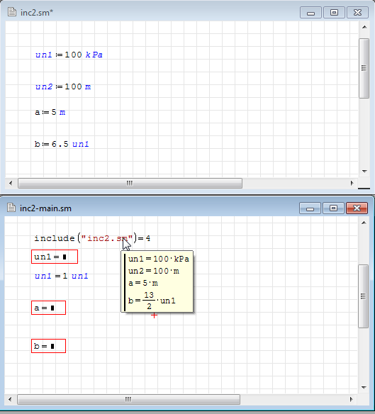

EDIT: Suppose that units are not handled yet
EDIT1: Yes, units are handled now .

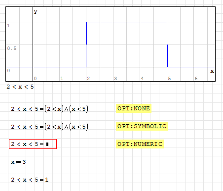

#12 Опубликовано: 10.11.2013 18:49:23
Andrey Ivashov 12.11.2013 18:45:00, Martin Kraska 10.11.2013 21:26:00
#13 Опубликовано: 10.11.2013 21:25:49
Davide, that is simply great! Does that mean that you can define arbitrary operator formats?
Then here is my wish-list
- cases (like sys, just with 2 columns, first value, second condition)
- at (vertical bar with subscript for the location)
- vec (boldfacing and non-scalar-declaration)
Can you make symbolic and numeric evaluation look differently?
#14 Опубликовано: 11.11.2013 07:17:56
Andrey's magic interfaces
As for now the first is in my plans and is possible to do; the 2nd and the 3rd are interesting but (as first impression) are closest to low-level operators than to functions, so I'm not sure that is possible to have something usable... Are just thoughts, maybe is possible, as usual step-by-step we will discover what we can do...
