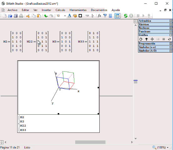

meanwhile I saw that the update button in the Graphics panel re-aligns the 3D plot objects and the co-ordinate axis objects. Even if that has the side effect of resetting the view (zoom, pan, orientation) the alignment is kept upon subsequent interactive view changes such that one is able to obtain sensible plots.
However, as soon as the graph is recalculated, the alignment is lost again. Also, when loading the file, the axes are mis-aligned and you have to re-adjust the graphs individually to reproduce the screen shot.
The screen shot shows that the co-ordinate system is definitely left handed. I'd vote for a change here.

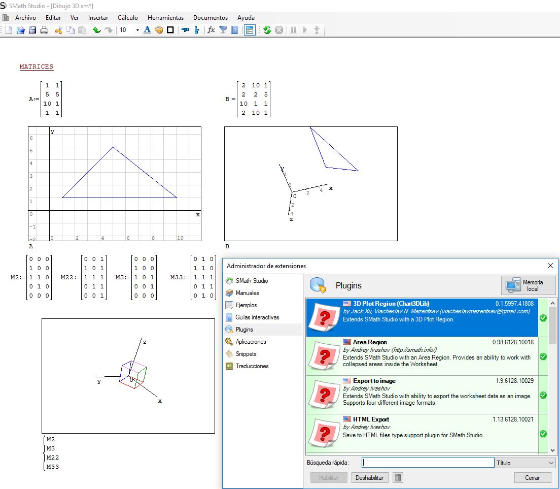

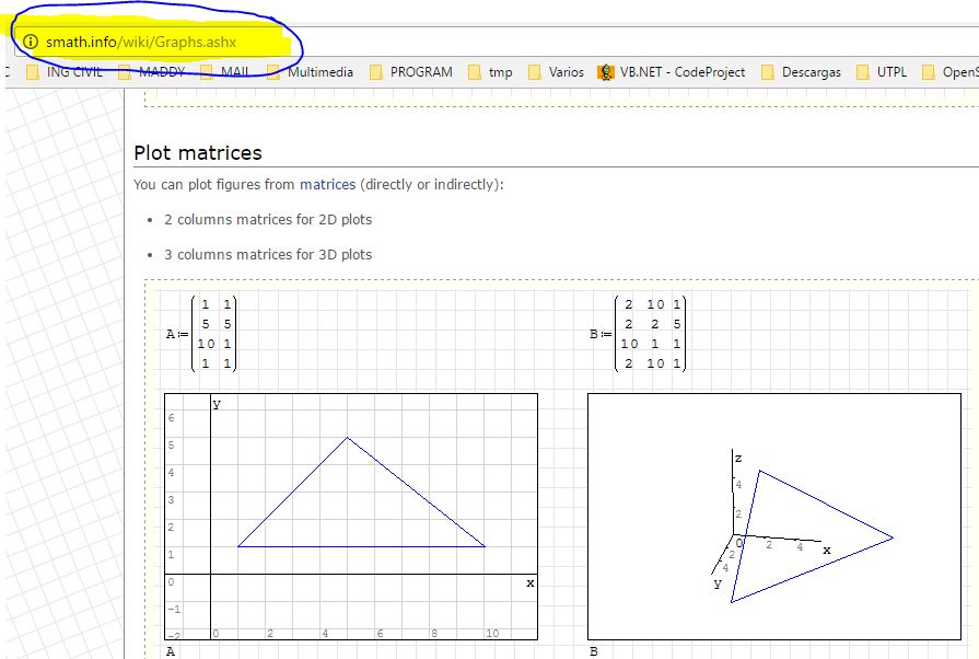

Hi, I am familiar with the Plot3D plugin and I have found that the graphs do not coalesce with the coordinate axes.
Is there any error defining the coordinate matrix?
According to the web help a 3D graphic should be presented as the following ..

When I define it in Smath 0.98 (Build 6128), the result is the following ..
I appreciate comments

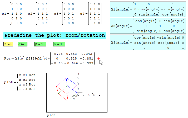

It is possible to apply the method
http://en.smath.info/forum/yaf_postst2215_Transferring-three-dimensional-image-on-a-two-dimensional--flat--graph-by-prof--A-B-Ivanov.aspx
1.sm (18,49 КиБ) скачан 1317 раз(а).
Davide Carpi 20.11.2016 15:36:00
Confirmed (but the plugin is Plot Region by Andrey Ivashov, not 3D plot region)
