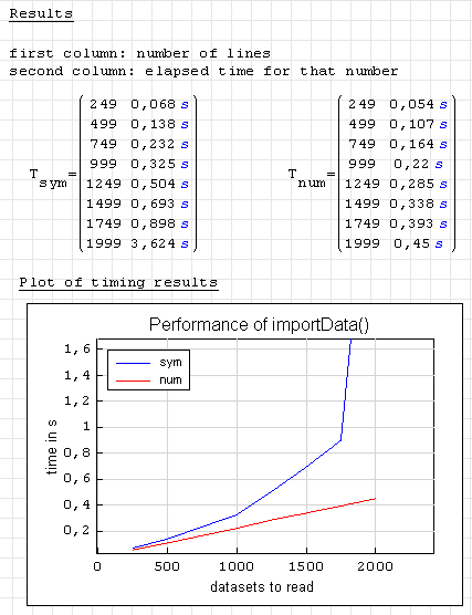

ioan92 and mkraska,
Thanks for the tips. The tips reduced the load/calculate times tremendously and now may be useful to me.
