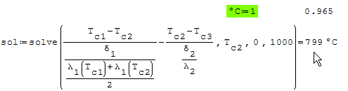

Why no solution ? ... Units ?
If you disable Units, you have a solution.
root is undocumented in Smath. However, we have applications.
Mathcad root is known to be inaccurate.
#4 Опубликовано: 22.05.2023 10:11:59
Solve Inverse [Seeded Scanner QUICK TRACK] Copy.sm (150,91 КиБ) скачан 1245 раз(а).

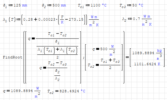

Solution from Alan Stevens
Krasnoshchekov-Sukomel-Alan.sm (206,24 КиБ) скачан 1443 раз(а).
#9 Опубликовано: 23.05.2023 09:34:25
Brilliant solution ... Thanks Valery

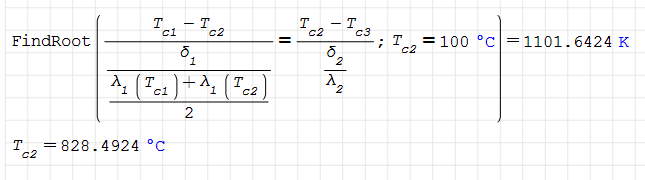

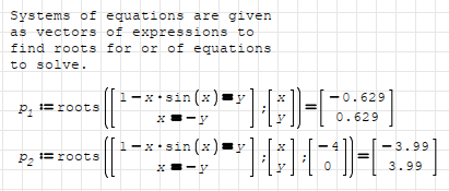

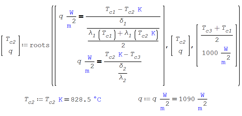

Can we do it with the Roots function with 2 or more equations and unknowns?
#11 Опубликовано: 23.05.2023 10:52:57
Can we do it with the roots function with 2 or more equations and unknowns?
Please, attach a document to evaluate the request.
#12 Опубликовано: 23.05.2023 11:05:22
Yes you can.
With inserting units, roots() can solve as solve() function.
roots() and Findroot() are both capable of solving system of equations.
Findroot() can solve without inserting units.
Sorry, done myself.
Krasnoshchekov-Sukomel-Alan.sm (13,42 КиБ) скачан 1443 раз(а).

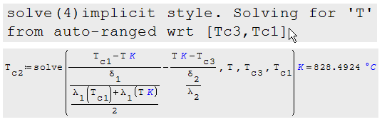

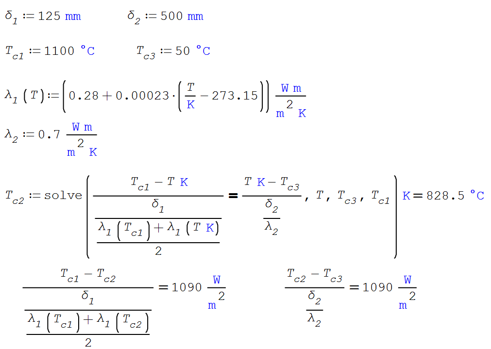

#14 Опубликовано: 23.05.2023 16:46:53
Sorry, done myself.
Here is an alternate way to solve your variables.
