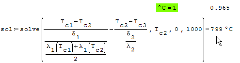

Why no solution?
Units?
Krasnoshchekov-Sukomel-10-10.sm (203.8 KiB) downloaded 1425 time(s).

#3 Posted: 5/22/2023 9:10:10 AM

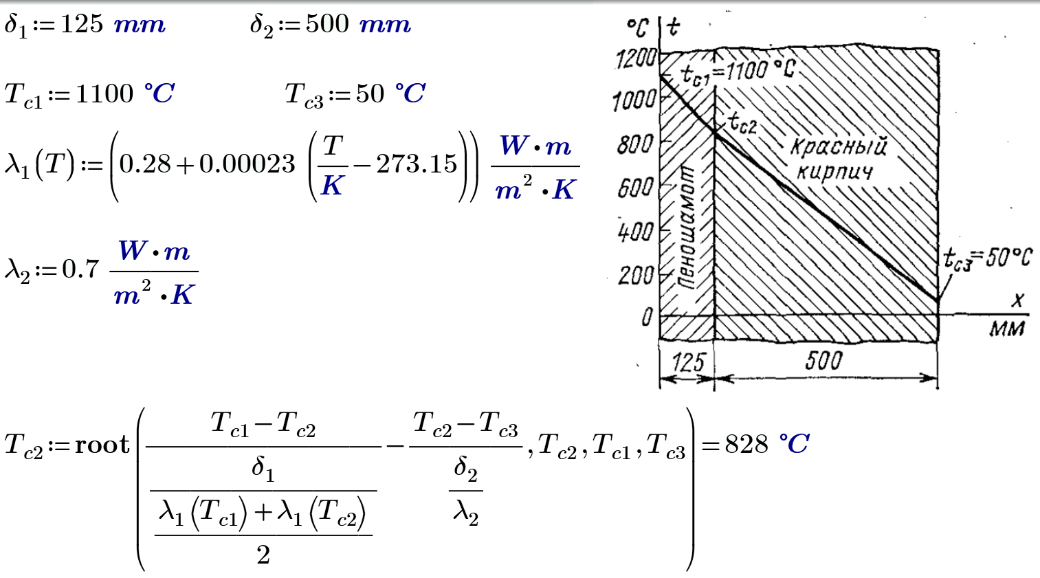

Why no solution ? ... Units ?
If you disable Units, you have a solution.
root is undocumented in Smath. However, we have applications.
Mathcad root is known to be inaccurate.

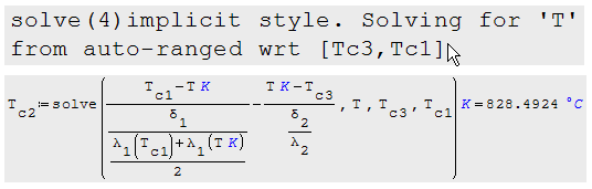

#4 Posted: 5/22/2023 10:11:59 AM
Solve Inverse [Seeded Scanner QUICK TRACK] Copy.sm (150.91 KiB) downloaded 1192 time(s).

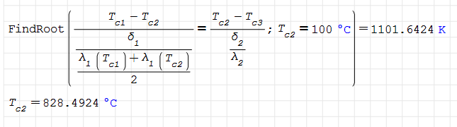

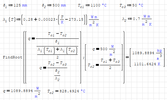

#5 Posted: 5/22/2023 12:51:11 PM
599 likes in 1,380 posts.
Use Findroot() for solving with units.
And your λ.2 part was different from original document.
Valery Ochkov 5/22/2023 1:17:00 PM
#6 Posted: 5/22/2023 1:17:54 PM
Valery Ochkov
Valery Ochkov
67 likes in 708 posts.
Send please the SMath file!
#7 Posted: 5/22/2023 5:55:55 PM
Krasnoshchekov-Sukomel-10-10_findroot.sm (206.95 KiB) downloaded 1412 time(s).

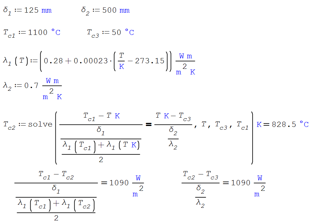

#8 Posted: 5/23/2023 1:42:30 AM
Valery Ochkov
Valery Ochkov
Solution from Alan Stevens
Krasnoshchekov-Sukomel-Alan.sm (206.24 KiB) downloaded 1393 time(s).
#9 Posted: 5/23/2023 9:34:25 AM
Brilliant solution ... Thanks Valery
Valery Ochkov 5/23/2023 9:40:00 AM

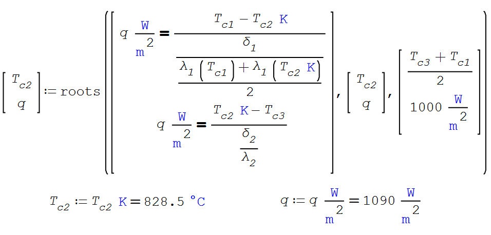

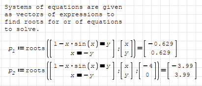

Can we do it with the Roots function with 2 or more equations and unknowns?
#11 Posted: 5/23/2023 10:52:57 AM
Can we do it with the roots function with 2 or more equations and unknowns?
Please, attach a document to evaluate the request.
#12 Posted: 5/23/2023 11:05:22 AM
Yes you can.
With inserting units, roots() can solve as solve() function.
roots() and Findroot() are both capable of solving system of equations.
Findroot() can solve without inserting units.
#13 Posted: 5/23/2023 11:33:39 AM
Valery Ochkov
Valery Ochkov
Sorry, done myself.
Krasnoshchekov-Sukomel-Alan.sm (13.42 KiB) downloaded 1391 time(s).
#14 Posted: 5/23/2023 4:46:53 PM
Sorry, done myself.
Here is an alternate way to solve your variables.
