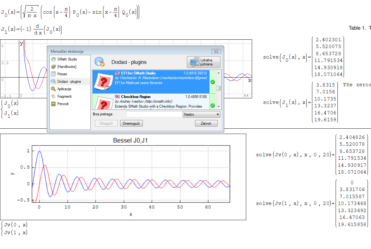

It seems I had a lucky guess this time. I've seen the EFI plugin in the Gallery. Installed it first and then copied the mathlib.dll in the place you mentioned. Bessel and other functions are back . Here is the result using the file by AlphaBeta. By the way, this much faster than using the approximation formulae.

Originally the library (and demo) was intended for Mathcad, where such functions are present.
It is strange that it works in Linux. I thought this plugin in Linux will not work.

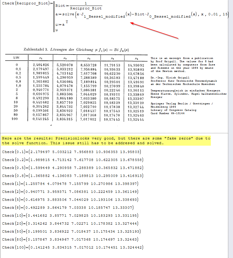

But nevertheless attached you can find my "home-brew"-approach towards the Bessel function.
Actually I only wanted to solve a heat transfer problem.
Now I am a litte bit
Also thanks to M. Kraska.
20130612 Bessel Modified.sm (1023,6 КиБ) скачан 1316 раз(а).
#15 Опубликовано: 12.06.2013 13:30:09
The results from solve() depends on the equation, range and decimal places (Tools|Options|Calculation Decimal places). See the result if you change the equation, give different range and set 15 decimal places.

thank you for your hint. I know that the solve function will produce some "ghost-zeros" in certain cases depending on the function, the range and the precision. I have sorted this out before by means of a little program within SMath using BiSection or NewtonRaphson, or using the initial zeros and then making a second, more refined "solve"-run using closer ranges. Additional knowledge about the functions periodicy is also helpful here.
