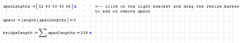

Hey guys.
Maybe someone has a solution for next problem:
I want to allow a user to receive bridge length by entering each span lengths separately.
For example first of all I have variable N (span numbers) that tells me how many times I need to enter span length.
I that possible?
#2 Опубликовано: 01.02.2019 06:28:41
1 440 сообщений из 2 929 понравились пользователям.
Simplest way:
With a more graphical approach, you can try with the modeller region.

Wow, thats works just well. Thanks

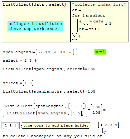

#4 Опубликовано: 01.02.2019 08:33:02
click in front to add upstream
click in back to add downstream
click in front demonstrated only.
So, you don't add separately, you select in group
or individually at will
