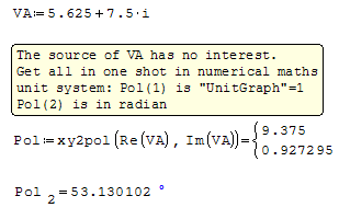

#4 Опубликовано: 05.06.2016 15:14:46
Better be in harmony wth the maths and Smath.
There is nothing to look gain, Smath is OK.
The Magnitude (length) and The Angle (angle) in polar coordinates have different units.
For sure they have different units: one is in "UnitGraph" the other is in "rad"
The rad is not a common unit. It is not correct.
YES: rad is correct, rad is the maths unit in trig approximations as well as in official tables.
If you want °: convert by appending ° in the Smath result

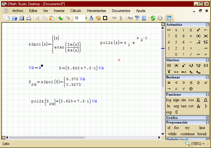

#8 Опубликовано: 05.06.2016 19:26:10
1 132 сообщений из 1 801 понравились пользователям.
Something like that?
Notice that atan2 ins't in SMath, which is more correct than atan for this functions (see http://www.mathworks.com/help/matlab/ref/atan2.html for example).

#9 Опубликовано: 05.06.2016 19:55:50
Mike Kaganski
Mike Kaganski
Mike,
The xy2pol does not work when units are included:
Do we agree?
Yes we do
Цитата
When eventually it is working:
The units of the "Magnitude" and the units of the angle, (for the case of complex numbers here), will be different.
Yes, that's what I show in my screenshot, that uses ≡ instead of =, just to show the desired result: seeing is better than reading.
Цитата
Note: I see you got W(att) how?
Now I suppose it's apparent: Ctrl+= and manually make system with desired result
Цитата
I see that you have a semicolon ( ; ) I have a comma (,).
Re(S);Im(S) versus Re(S),Im(S)
Russian locale default settings
С уважением, Михаил Каганский

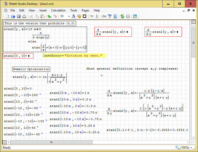

atan2.sm (35,42 КиБ) скачан 1232 раз(а).

#12 Опубликовано: 05.06.2016 20:58:58
Hi Mike. I prefer this other, but have some round inconvenients:
#13 Опубликовано: 05.06.2016 21:04:35
Mike Kaganski
Mike Kaganski
I guess that with the new try function samebody can make a good one atan2.
But with try, it won't differentiate again.
#14 Опубликовано: 05.06.2016 21:10:02
Oh, I think that this happen only to me :-). Not very sure that try don't accept diff.
So, this with numerical optimization must to be the best solution (until atan2 not be in SMath):
#15 Опубликовано: 05.06.2016 21:24:33
Mike Kaganski
Mike Kaganski
It's a good option, and only ~30% slower.

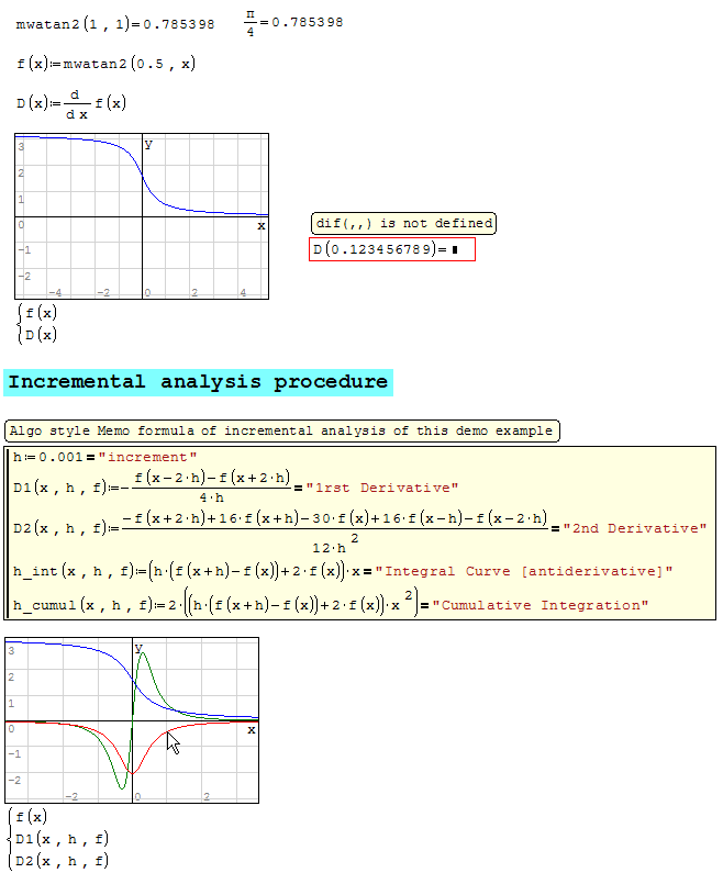

#16 Опубликовано: 06.06.2016 10:11:40
Like this Alvaro: look for the Matlb code in the f(x) menu,
look for mwatan2 ... if you have in your version: then go
Maths atan2.sm (10,93 КиБ) скачан 1272 раз(а).
