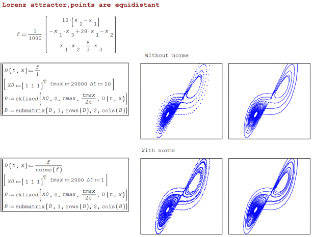

Thank you, Alvaro. The norme function simplifies the code and reduces the calculation time.
Example of using norme when solving ODE
LorenzPointsAreEquidistantc.sm (6,51 КиБ) скачан 1751 раз(а).
frapuano 09.11.2018 08:20:00, Alvaro 09.11.2018 12:19:00

Hi Ber. I don't remember to read nothing in the literature about equally spaced points in the numerical solution of the ode, except for the opposite: adaptive steps, but referring for the time variable, not the X,Y,Z solution points. About how you apparently get the same distance between solution points, i.e. sqrt(X^2+Y^2+Z^2), I guess that the background theory must to be in the Draghilev method and how the solution (X,Y,Z) is obtained from the differential equation. You have a very interesting point for investigate and publish about it.
I try to investigate the relationship between the symbolic ode solution and the paramatrization, but the symbolic solutions are quite complicated, and I don't have simple examples.
Apparently the distance between the points is 1 (guess can be easily proved because you divide by the norme the system), and this seems to provide more stable numerical solutions for the system (can be applied here Lyapunov's theorems?)
Unfortunately in this example I introduce the factor 1/1000 for avoid numerical over max limit error for the case without norme.

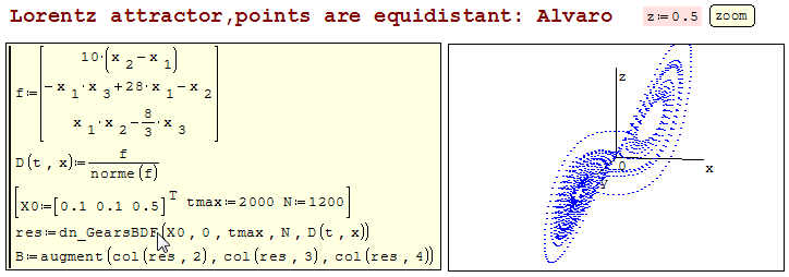

dn_GearsBDF is nearly ½ time. I think its Lorentz

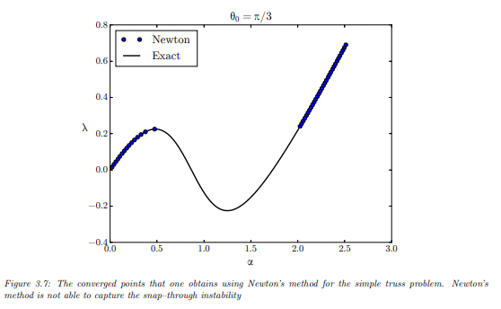

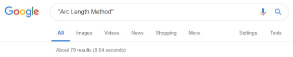

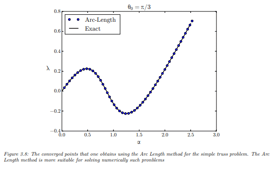

Thanks for the paper. Now you found the keywords for this point, which seems to be "Arc Length Method". This give only 79 results at google search:
Results are related with mechanical engineering for finite elements analysis. From the first result, having this attached file: https://scholar.harvard.edu/files/vasios/files/ArcLength.pdf
But actually I don't find any appointment nor observation that solution points are equally spaced. Notice that It could be some "obvious" point for, given f(t,x,x' ) = 0, plot for x(t) it's equally spaced if one transform it to f(s,x,x' ) with s as the arc length. But it's immediate for me that the plot for the state space (x,x' ) seems to be equally spaced too, as in some smath examples here in this topic.
Also, for the observation that can apply Lyapunov theorems about stability of solutions, there are some references in the 79 google's search results. The application here of Lyapunov is related about the stability of the found solutions, because authors using the parametrization along the arc length for ill conditioned systems.

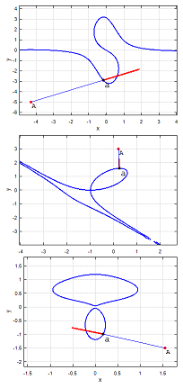

Finding Minimum Distanceof a Point from Curve
(with Draghilev method)
MinDistDragilev.sm (23,18 КиБ) скачан 1713 раз(а).
Davide Carpi 25.03.2019 08:39:00, Andrey Ivashov 26.02.2019 16:12:00, sergio 26.02.2019 16:47:00, Alvaro 26.02.2019 17:37:00

Finding Minimum Distance of a Point from Curve
Thanks Ber7 ... works fine.

Distance from point to implicit curve(with al_nleqsolve)
A thick red line is the normal to the curve at point a.
FindDist.pdf (243,33 КиБ) скачан 1133 раз(а).
FindDist.sm (72,1 КиБ) скачан 1749 раз(а).
frapuano 13.03.2019 17:49:00, NDTM Amarasekera 13.03.2019 15:38:00, Andrey Ivashov 13.03.2019 17:23:00, Davide Carpi 25.03.2019 08:39:00

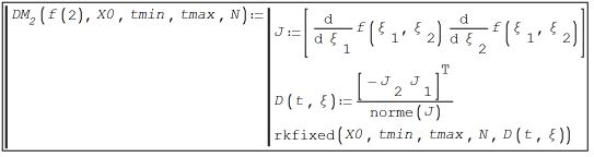

Refined the algorithm and added examples
DistMod.sm (51,49 КиБ) скачан 1672 раз(а).
