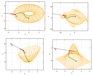

#67 Опубликовано: 02.04.2019 15:52:56
Fridel Selitsky
Fridel Selitsky
Finding Distance of a Point from Surface
The difference from the program distance to the curve in only one expression:
in the top line instead of i: = (1 ... 2)) we have i: = (1 ... 3).
A is a given point, a is its projection to the surface, Аa (k) is the length of the segment Аa (k)
to the surface, the h-step of decreasing the distance, a (k) is the intermediate coordinate of
the point touch.The red line is the normal, the green is the trajectory of the movement of the
point a (k) from the initial the position of a (1) to the final a.I borrowed the trajectory
demonstration from Razonar,to whom I express my gratitude.
Dist3d.sm (63,12 КиБ) скачан 1718 раз(а).
Вячеслав Мезенцев 02.04.2019 18:23:00, Alvaro 02.04.2019 17:46:00, NDTM Amarasekera 03.04.2019 12:15:00, Andrey Ivashov 03.04.2019 03:23:00

#70 Опубликовано: 03.04.2019 22:20:28
Hi. Attached version have some reformulations, but is essentially the same, just added Lagrange multipliers for refine last point and join 3D and 2D in only one procedure. Maybe don't works in all cases, I guess that because use less points, but is more pedagogical from my point of view.
Dist.sm (172,04 КиБ) скачан 1741 раз(а).
Dist.pdf (500,48 КиБ) скачан 1048 раз(а).
Fridel Selitsky 04.04.2019 01:24:00

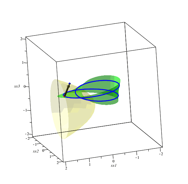

#73 Опубликовано: 05.04.2019 09:15:14
алексей
алексей
17 сообщений из 78 понравились пользователям.
“Finding Distance of a Point from curve or surface” - not far the best application of the Draghilev method.
An example of the projection of points from one surface to another using the optimization methods in Maple.

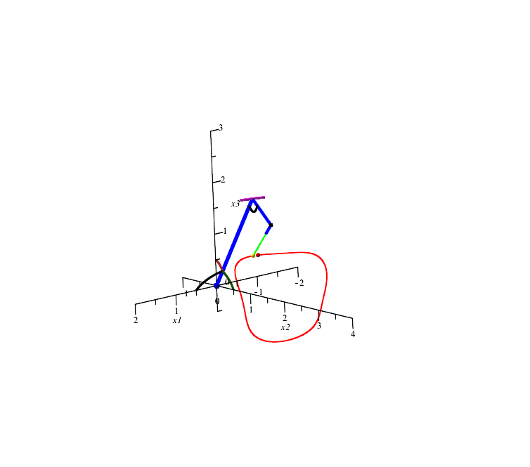

#75 Опубликовано: 05.04.2019 14:41:42
алексей
алексей
It seems to me that the Draghilev method is intended for a “large” number of variables with a “small” number of equations.
For example, as in the case of solving the inverse problem of kinematics for a three-link manipulator with a variable length of the working link. This manipulator has 6 degrees of freedom.

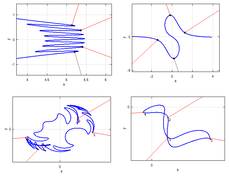

#77 Опубликовано: 02.10.2020 15:43:22
Fridel Selitsky
Fridel Selitsky
Point Orthogonal Projection onto a flat or spatial Curve
Calculation procedure
1. We will use Draghilev's method
a) to parameterizethe curves and find a good initial guess.
We will use the point a0, found by the minimum distance
from the curve to a given point P.
b) to calculate the unit vector of the tangent T (x) to a
point on the curve.
2 To the system of equations we add an equation that
expresses the conditions of perpendicularityof the tangent
at the point x of the curve and the segment connecting the
points P and x. This means that the inner product of the unit
tangent vector to the curve f (x) and the unit vector Px is
equal to zero. As a result, we obtain the system of equations
3. We solve the system with the initial assumption a0
distantion.sm (124,14 КиБ) скачан 1747 раз(а).
Trascidental curves.pdf (394,93 КиБ) скачан 1056 раз(а).
NDTM Amarasekera 03.10.2020 12:08:00, Davide Carpi 02.10.2020 16:26:00, Andrey Ivashov 02.10.2020 17:25:00

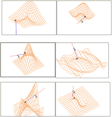

#79 Опубликовано: 02.12.2020 06:12:07
Fridel Selitsky
Fridel Selitsky
Distance and projection of a point onto a parametric surface
ParSur.sm (74,98 КиБ) скачан 1898 раз(а).
ParSur.pdf (619,79 КиБ) скачан 1261 раз(а).
Alvaro 02.12.2020 18:21:00
