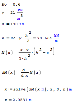

It works like this:

It works like this:
Hello! For your x solve how come you put h in the brackets when it is a constant? The post above yours doesn't have as many inputs but appears to accomplish the same thing. What are the extras in your solve call doing?

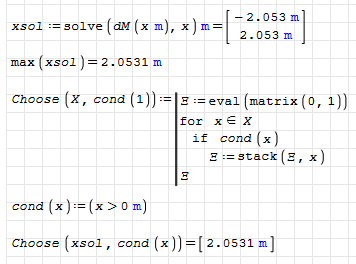

Is there a way to have the solve only spit out the positive number for x instead of a matrix?
The '0' and the 'h' are the limits of x between which 'solve' searches for a solution.
#7 Опубликовано: 15.08.2025 18:41:53
... Is there a way to have the solve only spit out the positive number for x instead of a matrix?
Hi DM. There are several ways. This two, for example:
Moment Test.sm (33,91 КиБ) скачан 1414 раз(а).

Hi Stv. Which solve?
Hi Alvaro,
Not sure what you're getting at! I simply took the 'solve' that DM had used and added the two limits (0 and h), as well as inserting units.

#9 Опубликовано: 15.08.2025 22:19:04
... Not sure what you're getting at! I simply took the 'solve' that DM had used and added the two limits (0 and h), as well as inserting units. ...
It seems my browser didn't load the image you attached when I ask about which solve. I just saw your image now. You're right; the most practical way is to limit the search to the range [0, h].
