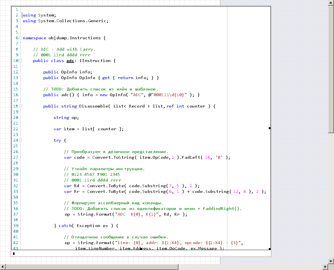

I'm trying to make an editor for scripts and I need more events:
OnKeyUp, OnKeyPress
OnClick, OnDoubleClick,
OnGotFocus, OnLostFocus
Now I have to somehow imitate them.

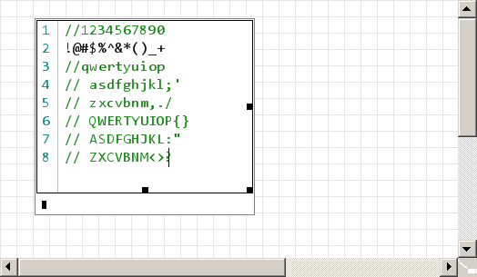

Unfortunately, no. But I can tell how to simulate OnKeyPress().
    public class KeyCodeToAscii {
	    [DllImport("User32.dll"]
	    public static extern int ToAscii(int uVirtKey, int uScanCode, byte[] lpbKeyState, byte[] lpChar, int uFlags);
	    public static extern int GetKeyboardState(byte[] pbKeyState);
	    public static char GetAsciiCharacter(int uVirtKey) {
		    var lpKeyState = new byte[256];
            GetKeyboardState( lpKeyState );
            var lpChar = new byte[2];
		    if ( ToAscii( uVirtKey, 0, lpKeyState, lpChar, 0 ) == 1) {
                return Convert.ToChar( ( lpChar[0] ) );
		    } else {
                return new char();
and
public override void OnKeyDown( KeyEventArgs e ) {
    var keyChar = KeyCodeToAscii.GetAsciiCharacter( e.KeyValue );
    OnKeyPress( new KeyPressEventArgs( keyChar ) );
public void OnKeyPress( KeyPressEventArgs e ) {
But it works only with english characters.
