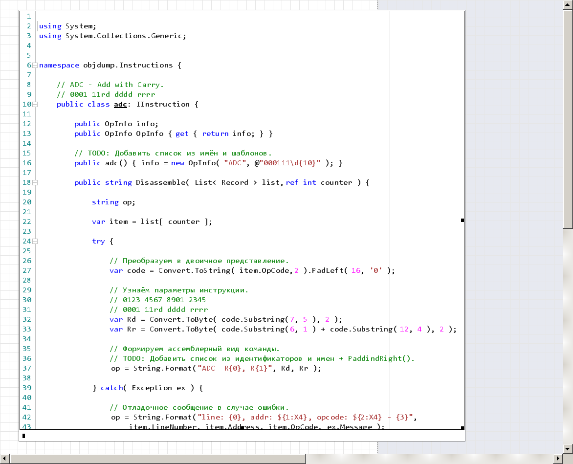

I'm trying to make an editor for scripts and I need more events:
OnKeyUp, OnKeyPress
OnClick, OnDoubleClick,
OnGotFocus, OnLostFocus
Now I have to somehow imitate them.
