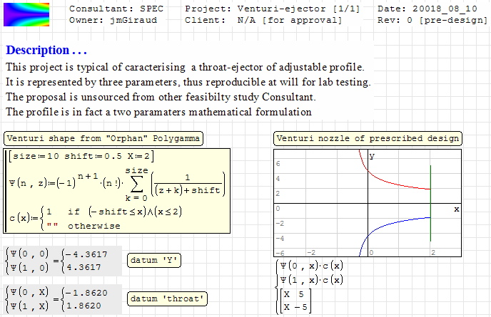

Thanks.Interesting how you've combined a background image
Do you really know what you want ?
Such a big horrible logo at the top of each page as you ask before ?
Or my suggestion from a saved *.sm that you open and immediately
copy/paste in blank sheet, close the original and go for the project ?
BTW: you don't have to save the logo image as whatever [*.PNG, *.BMP]
you capture, the word is capture from the screen and paste in Smath
work sheet. My preferred capture tool is WinGrab [freeware].
Did you open my attachment Smath document ?
Did the PDF opens ?

#23 Опубликовано: 10.08.2018 09:33:39
However, the downside is that it is a manual operation for each page ..
Good thing is it a personalized construction. If I would be your client, I would reject
having that stuff at top of each page, breaking the visual suite of project calculations
that span more than one sheet.
The footer is universal at bottom n/N
The header is by default:
1. Universal local time at the machine
2. Document identification
Header & Footer appear on the printed document, no need to have that crowd
the project work sheet. As your client, would reject that as well.
Add extra in the Header: &[DATE] &[TIME] - &[FILENAME] - [Rev_1: Geoff]
As plain as possible, text white background [254,254,254]
Once your company logo has been capture and pasted,
it is resident in the Smath work sheet, i.e: the saved Cartouche template.
Assume your are the Grand Savant of something, I'm your client.
For sure, if your maths are too much for me, I will have the design proofed
by some independent competence that will surely dislike the Cartouche at
the top of each page, particularly if I give him a PDF.
All those are just comments. Cheers ... Jean

Just one question : I assume you're 'manually' copying the formatted labels from page to page ?
.. i.e. if calcs remain 'static', the header alignment is AOK.
However, if content is inserted in e.g. page 1, the header content would have to be realigned on subsequent pages, right ?
Both your observations are correct. Yes, when a new sheet is added the formatted labels are are copied and pasted to the new sheet. And when Areas are added to the calculation page expanding and contracting the area moves all the labels.
But you only do this once setting up the calculation sheet. And if this a repetitive calculation that is required on many projects then the pages are ready to go. I would guess you would say this is a work-around as opposed to something like a Word doc header.
