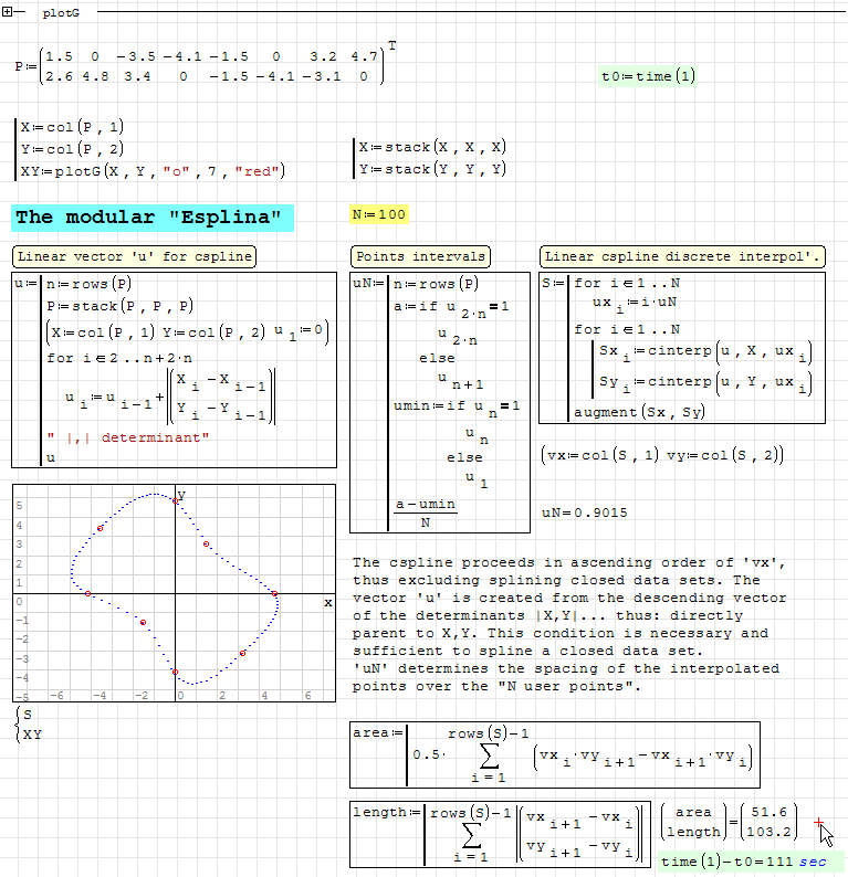

This one works well for the given data set. Mesh finer at will and if needed,
bilinear ... not much use for bilinear, whereas "spline" is just something.
Spline Esplina [AI2000].sm (23,66 КиБ) скачан 1208 раз(а).

... a faster version: one twin col extractor removed.
By same token, I wonder why the col extractor col(,,) is so slow ?
Spline Esplina [AI2000].sm (23,75 КиБ) скачан 1232 раз(а).

You can speed up calculation if o are using "eval":
Spline Esplina [AI2000] (1).sm (25,27 КиБ) скачан 1219 раз(а).

Thanks Ber7 for "speedy Gonzalez". In fact, the "uN"
conditional code is redundant in this dataset.
Here is the latest version, even faster.
Spline Esplina [AI2000].sm (23,66 КиБ) скачан 1255 раз(а).

Jean,calculation speed will be doubled, if we use the advice of Андрей
http://en.smath.info/forum/resource.ashx?a=14504&b=2
Spline Esplina [AI2000] 2.sm (20,98 КиБ) скачан 1261 раз(а).

Thanks Ber7,
... now she is a bomb [2 sec] !
Spline Esplina [AI2000].sm (22,82 КиБ) скачан 1273 раз(а).

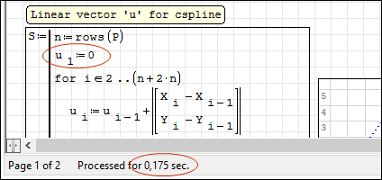

Группа: Super Administrator
You forgot to specify first element of u vector.
By doing so you can speed up calculation even more:
Regards.
Thanks Andrey, damned me !

Actually I'm not sure why calculation of u is so complex... looks like it is just a copy of m.

Quite right Andrey: 'u' is 'm', which 'm' is redundant.
