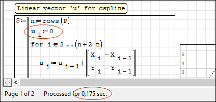

You forgot to specify first element of u vector.
By doing so you can speed up calculation even more:
Regards.

#8 Опубликовано: 13.09.2016 12:08:37
Thanks Andrey, damned me !
While you are there, can you speed up "DeBoor" ?

The main change was this:
Actually I'm not sure why calculation of u is so complex... looks like it is just a copy of m.
