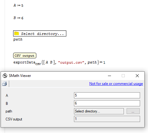

can I use this plugin (csv export) in viewer/exe file? so user can get output from exe file

Yes, you can. If you want to let the user choose a path, there is the path picker region, otherwise you might choose a default output, f.e. if you choose an empty string as third argument ("") the file will be created next to the executable.
