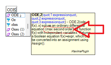

Why is saying that its not a proper differential equation?
#2 Опубликовано: 07.10.2024 17:20:54
StvMath
StvMath
44 сообщений из 71 понравились и 1 не понравились пользователям.

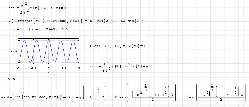

And then if someone wants to solve a > 2 order differential equation (3th order, 4th order, etc), how to do it? What algorithm, command should I use/rely in SMath Studio?

And there are also some approach using maxima engine/command?

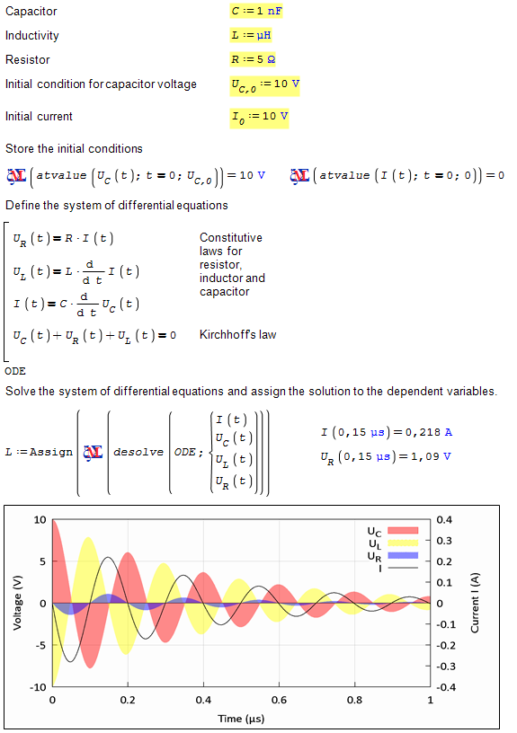

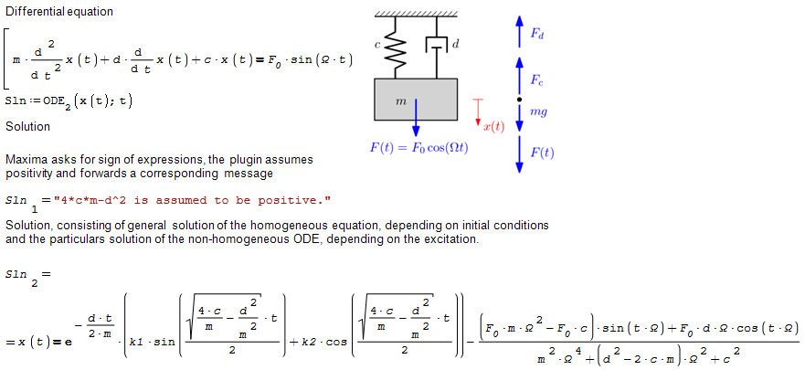

Sure. Here is one using Maxima's desolve function and one using ODE.2 (without solving for the integration constants)
RLC.sm (23,17 КиБ) скачан 1504 раз(а).
Feder-Masse.sm (23,13 КиБ) скачан 1527 раз(а).

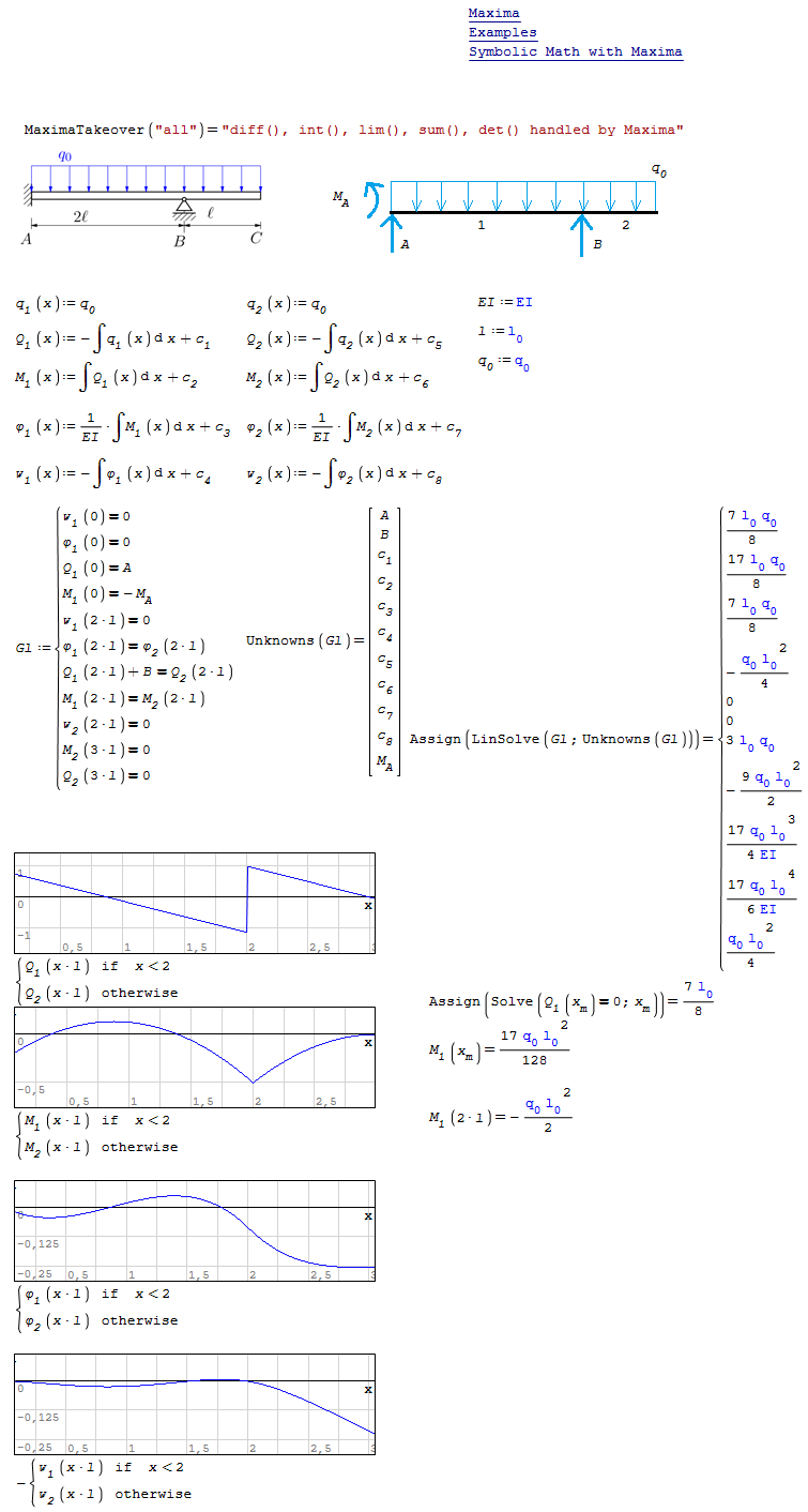

Here I cirumvent the limitations of the translation using multiple intervals of integration. Example from the interactive handbook.
Worksheet36.sm (40,73 КиБ) скачан 2186 раз(а).
