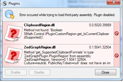

Why they do not load?
Thank you,
Basile

These plugins are outdated since SMath Studio 0.96.5146; as mentioned here these plugins shouldn't be visible, anyway about ClipboardRegion the development will continue when the clipboard issues of SMath Studio will be fixed.
best regards,
Davide
