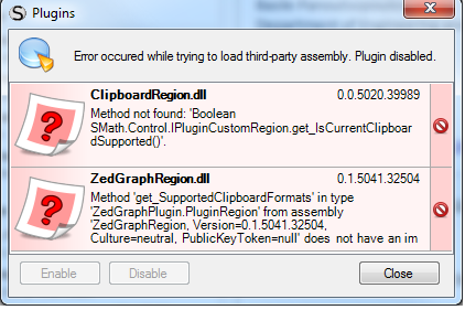

Why they do not load?
Thank you,
Basile
#2 Опубликовано: 22.05.2014 09:49:34
1 441 сообщений из 2 930 понравились пользователям.
These plugins are outdated since SMath Studio 0.96.5146; as mentioned here these plugins shouldn't be visible, anyway about ClipboardRegion the development will continue when the clipboard issues of SMath Studio will be fixed.
