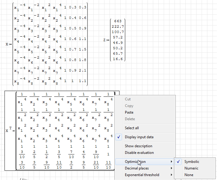

i'm new here but i need your help,
approximation of one variable, but x is unknown and it asks me to define what I do?
below the screen.

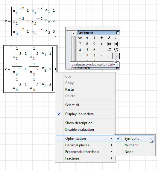

Hi Mode,
with symbolic data you must use the symbolic evaluation; you have 3 ways to do that:
- type CTRL+. from keyboard
- click the symbol from the Arithmetic toolbox
- select Optimization -> Symbolic from the context menu
regards,
w3b5urf3r

#4 Опубликовано: 09.01.2013 13:06:07
Unfortunetly still have the same problem.
I do as u say and make it symbolic but he still want to define x1
I don't understand why... please look the attachments
P.S. it's preferable to attach files and images directly in the forum instead of using external services
