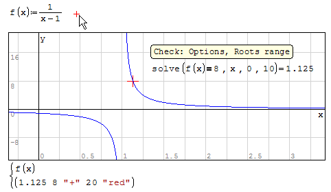

The discontinuity of the function at x = 1 creates some numerical problem.
As shown in the figure, trying different intervals are obtained unexpected values.
[albumimg]1436[/albumimg]
... always plot before solving, bracket the range wisely [1,2]
