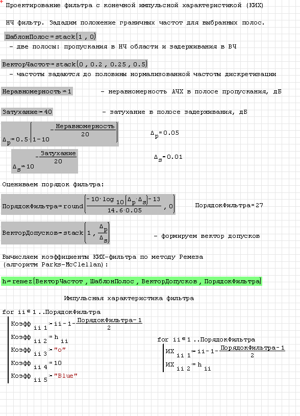

FIR Filter Design
Functions list: remez(4), remez2(4).
remez(vg, vr, vw, n) Returns coefficients for a FIR filter of length n generated by the Remez exchange algorithm.
Arguments:
- vg is a real vector, a grid of frequencies between 0 and 0.5.
- vr is a real vector of values between 0 and 1, length: vg / 2. Contains the frequency response over vg.
- vw is a real vector of values between 0 and 1, the same length as vr. Contains error weight over vg.
- n is an integer, the length of the filter.
Links:
1. Based on Parks-McClellan algorithm for FIR filter design (C version) by Jake Janovetz (part of the Analysis of Functional NeuroImages - a set of C programs for processing, analyzing, and displaying functional MRI (FMRI) data).
2. Parks-McClellan filter design algorithm.
remez.sm (13,43 КиБ) скачан 1907 раз(а).
remez.pdf (48,9 КиБ) скачан 1225 раз(а).

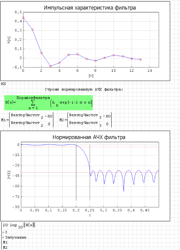

Plugin updated. Please try.
Changes:
- remez2() function added.
Links:
1. Sources from tomtit
2. Test example for remez2().
Calculation of digital filter coefficients for emulation/design High-Class Audio Multi-function Digital Filter SM5842AP/APT.
High-Class Audio Multi-function Digital Filter (SM5842AP-APT).sm (26,64 КиБ) скачан 1733 раз(а).
High-Class Audio Multi-function Digital Filter (SM5842AP-APT).pdf (169,04 КиБ) скачан 1003 раз(а).
SM5842AP.pdf (218,37 КиБ) скачан 1243 раз(а).
