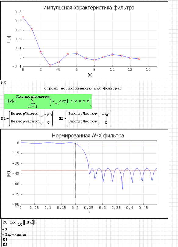

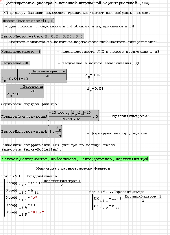

FIR Filter Design
Functions list: remez(4), remez2(4).
remez(vg, vr, vw, n) Returns coefficients for a FIR filter of length n generated by the Remez exchange algorithm.
Arguments:
- vg is a real vector, a grid of frequencies between 0 and 0.5.
- vr is a real vector of values between 0 and 1, length: vg / 2. Contains the frequency response over vg.
- vw is a real vector of values between 0 and 1, the same length as vr. Contains error weight over vg.
- n is an integer, the length of the filter.
Links:
1. Based on Parks-McClellan algorithm for FIR filter design (C version) by Jake Janovetz (part of the Analysis of Functional NeuroImages - a set of C programs for processing, analyzing, and displaying functional MRI (FMRI) data).
2. Parks-McClellan filter design algorithm.
remez.sm (13.43 KiB) downloaded 1907 time(s).
remez.pdf (48.9 KiB) downloaded 1225 time(s).

1. Design FIR band-pass/stop filters up to length ~2000
FIRFilterDesign. Example 1 (rus).pdf (100.06 KiB) downloaded 1132 time(s).
