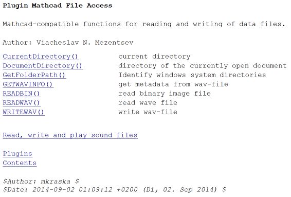

#3 Опубликовано: 19.08.2018 20:13:21
Is it possible to add the file path in addition to the filename in the window title bar?
Or maybe make it a preferences checkbox option.
Often times when using a repetitive calculation, I find that I am working on the one in the wrong folder.
Hi. You can see the Document Directory with the Mathcad Plugin, not in the toolbar but in the SMath document:
