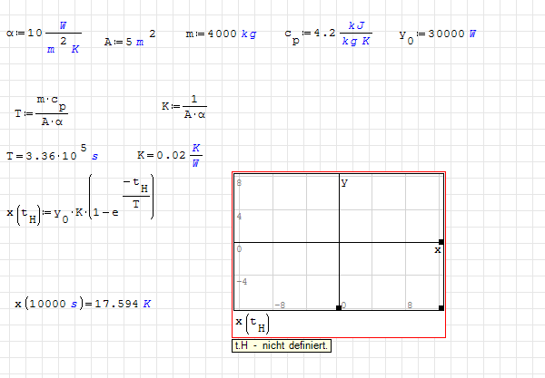

Lerch
Lerch
Hi all
2D Plot does not work with units
I tried to plot a function according the instruction of Sebastian Schluricke shown at www.youtube.com/watch?v=AtICkHXHFpk
His example I could easily do. But as soon if I go over to my calculations where I work with units I cannot plot them. I receive only the message variable not defined.
What is wrong here?
Kind regards
Gaselhul
