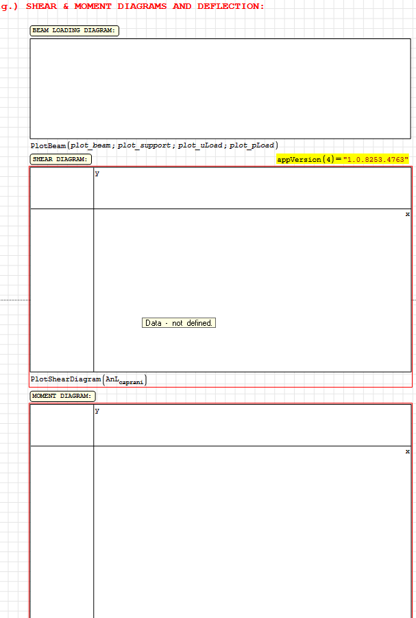

Hi everyone,
I have been using Smath for many years, but this is my first time writing to the forum
I have a problem with Structural Beam Analysis plugin. I download the Beam Analysis Input Guide from Extansions Manager and didn't change anything in the Smath file.
I couldn't figure out what is causing this situation. Do you have any idea?
Thanks in advance,

work fine for me, maybe -->
This worksheet requires that the associated Plugin (Structural Beam Analysis
Utility Functions by Redem Legaspi Jr.) be downloaded and enabled from SMath
Studio Extension Manager tool.

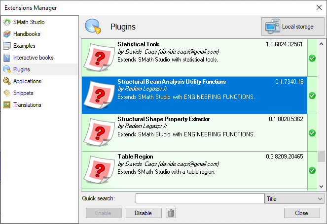

#25 Опубликовано: 16.09.2022 10:24:58
Safak
Safak
Thank you for your reply. The plugin was already enabled.

It's like there's a missing data
