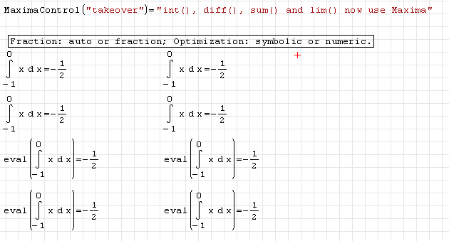

I don't know if this problem has been already reported, but I see some weird behavior with some simple integrals, this happen when I try different kind of optimizations (symbolic, numeric or none) at the same time I try different kind of fraction convertions(decimal, fracction or auto), when I try the eval function I get the same problem.
I attach a file done in the latest stable version (0.96 build: 4868), showing this behavior.
Wrong_sign_1.sm (13,11 КиБ) скачан 1202 раз(а).
