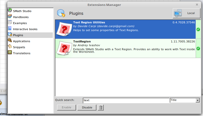

Text region Utilities is a different addin and provides (even) the "toolbox region".
If you search "text" in your extensions manager and you have the plugin installed you should see something like this (SS 0.99.7005):

I have Text Region Utilities now. Is there a way to use search and replace to just search a selected portion of the worksheet, and not search the whole worksheet? Can I select a certain portion of the worksheet and have SMath search and replace for just the selected area?
