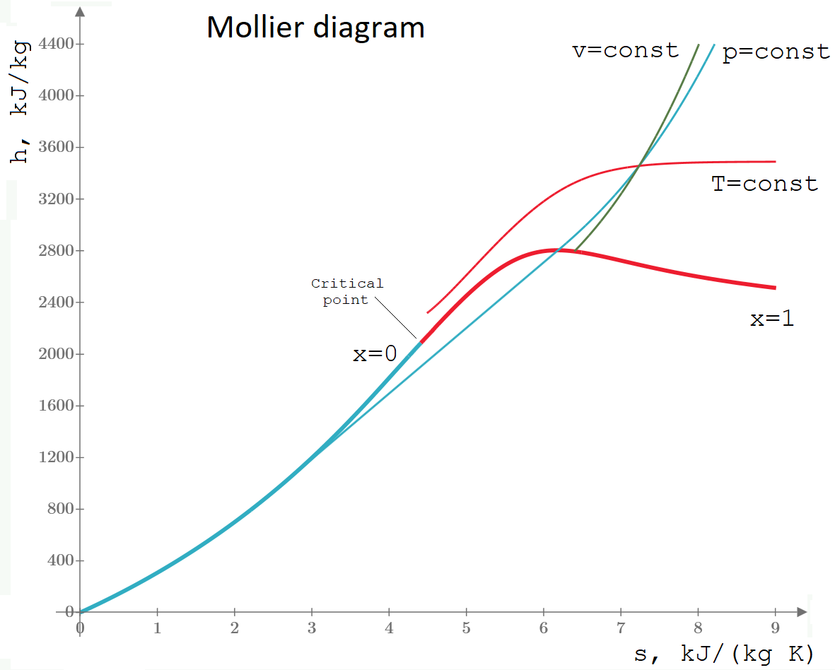

#1 Опубликовано: 20.05.2024 18:28:22
Valery Ochkov
Valery Ochkov
#2 Опубликовано: 21.05.2024 00:44:16

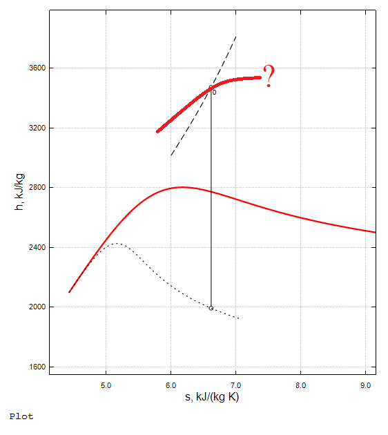

Hi. Comparing the result with the other water compound implementation.
h-s-diagram-Steam.sm (28,14 КиБ) скачан 1538 раз(а).
Valery Ochkov 21.05.2024 01:34:00

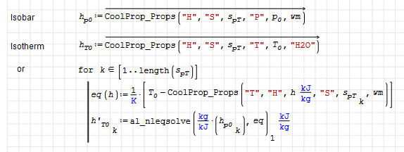

#3 Опубликовано: 21.05.2024 01:38:28
Valery Ochkov
Valery Ochkov
My solution. Now I'm thinking about isochore and second isotherm.
h-s-diagram-Steam.sm (31,02 КиБ) скачан 1603 раз(а).

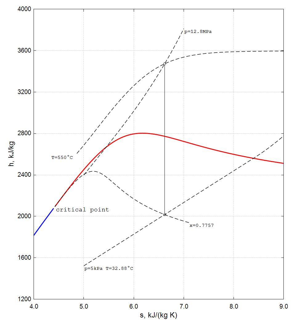

#4 Опубликовано: 21.05.2024 11:03:47
Valery Ochkov
Valery Ochkov
With Mathcad Prime and WaterSteamPro

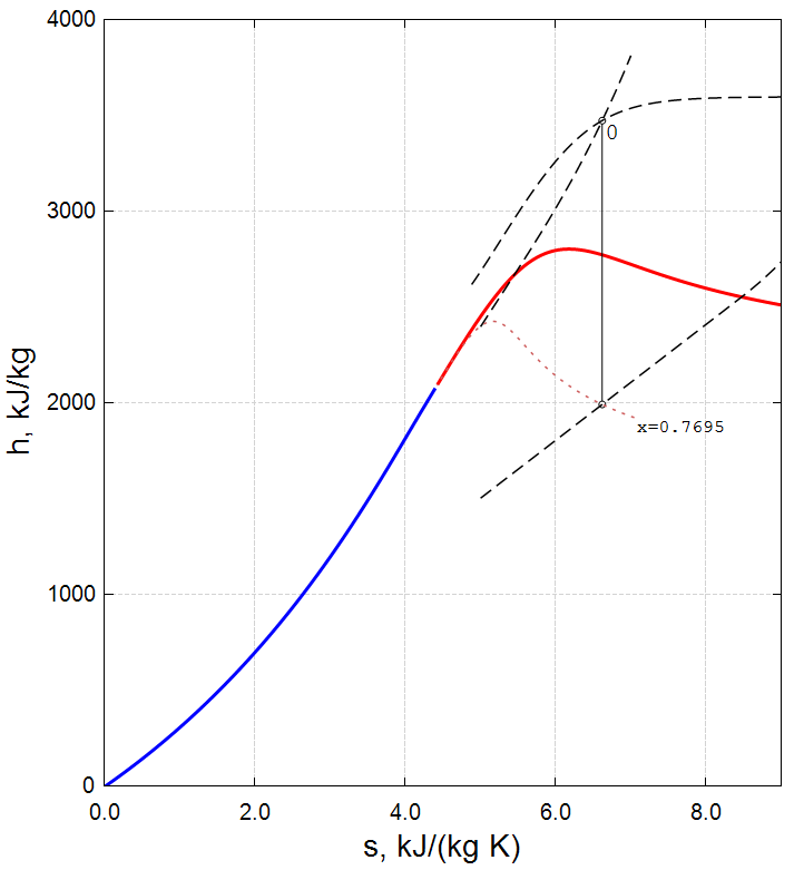

#5 Опубликовано: 22.05.2024 17:06:11
Valery Ochkov
Valery Ochkov
New version
h-s-diagram-Steam.sm (41,67 КиБ) скачан 1581 раз(а).
