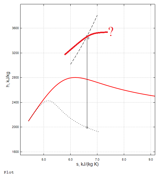

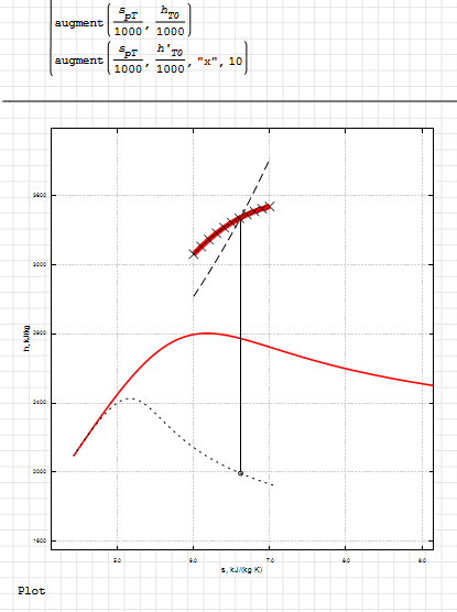

Hi. Comparing the result with the other water compound implementation.
h-s-diagram-Steam.sm (28,14 КиБ) скачан 1396 раз(а).

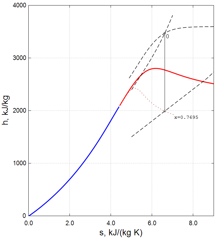

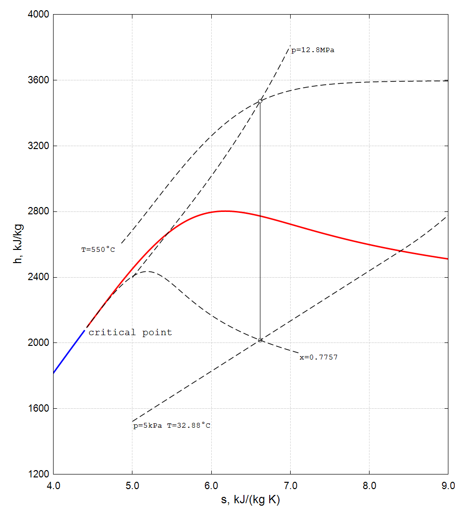

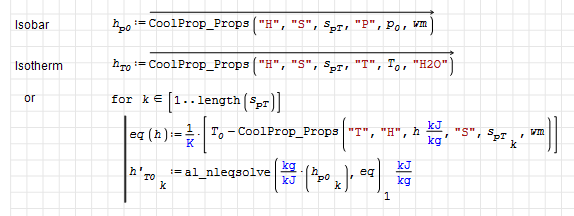

My solution. Now I'm thinking about isochore and second isotherm.
h-s-diagram-Steam.sm (31,02 КиБ) скачан 1459 раз(а).
