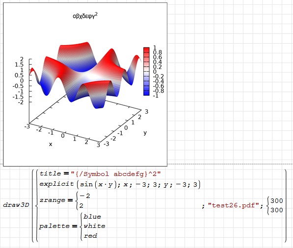

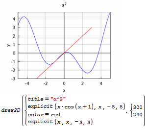

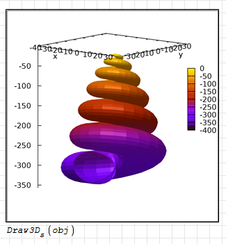

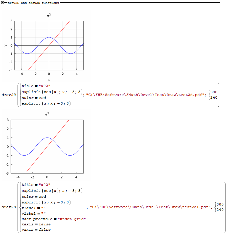

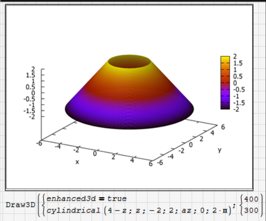

#321 Опубликовано: 20.06.2025 22:17:29
Draw2D() works.
Draw3D() also works.
Отредактировано 20.06.2025 22:18:20

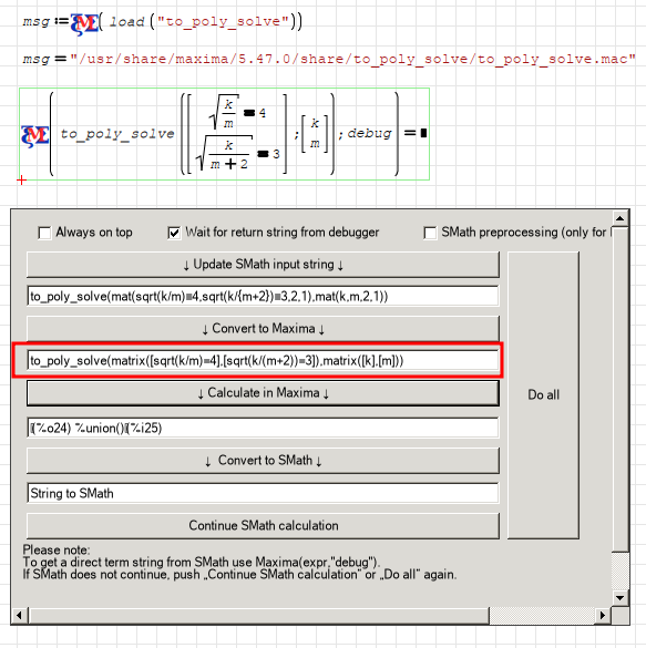

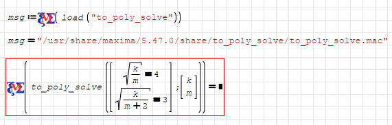

#323 Опубликовано: 28.08.2025 18:57:43
This doesn't work, yet it should.
When I debugged it, obviously something is wrong with syntax.
When I corrected it, it could calculate finally.
Otherwise, this equations can't be solved with smath-maxima.
#324 Опубликовано: 28.08.2025 19:37:07
according to the Maxima reference to_poly_solve wants lists or sets as arguments, not matrices.
overlord 28.08.2025 19:44:03

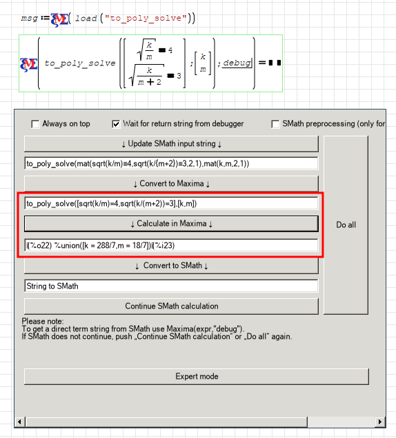

#325 Опубликовано: 28.08.2025 19:47:08
I thought it need matrices since all maxima Solve() examples in Reference Book are with matrix.
Thanks
Any opinion how to get rid of that union()?
Отредактировано 28.08.2025 19:49:17
#326 Опубликовано: 28.08.2025 19:57:08
Solve is a special case, because it is not a direct call to Maxima's function solve() but a lot of work has been done to make it more forgivable in the input format, just like FindRoot(), there you can feed matrices or lists and I would not be surprised if also line() would work.
Also, solve() returns it result as a nested list of lists if there is more than one solution. Nested lists don't survive in SMath processing, so we had to replace the outer list by a matrix (row vector, for better optics).
This all is not done if you use direct calls via the maxima function. The to_poly_function obviously uses the union() expression as wrapping construct for multiple solutions, which should be safe. Yet, you have to find out yourself, how to access the individual arguments of union() to access individual solutions. The arg() function does the job,
Отредактировано 28.08.2025 19:59:06
Oscar Campo 29.08.2025 09:39:23, francesco rapuano 29.08.2025 11:01:38, overlord 29.08.2025 14:49:52
