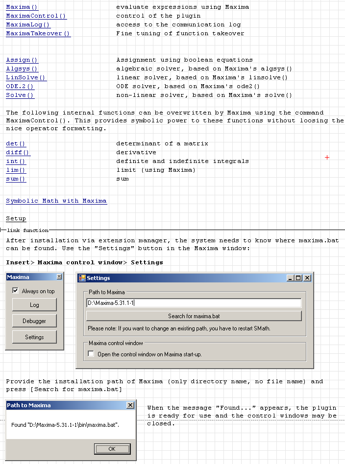

The Maxima plugin is an interface between SMath Studio and the free and open source computer algebra program Maxima.

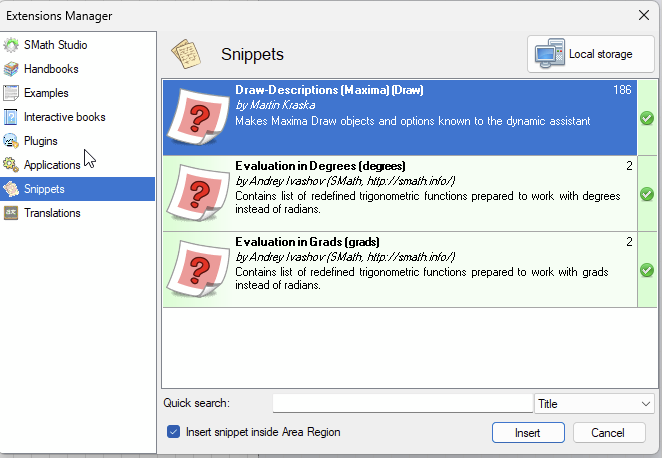

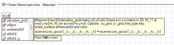

For the work with Maxima based 2D and 3D graphics, see the snippet Draw Descriptions

Due to registring a path to Maxima during setup, SMath is not really portable any more unless you can use the same Maxima path on different systems

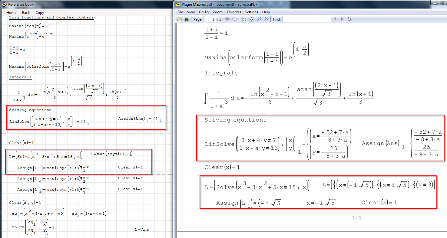

Maxima-diff() seems to trouble functions from Nonlinear Solvers. I hope this can be fixed, or Davide finds a smart way to adjust to it without rewriting everything. Last resort would be to provide the functions directly based on Maxima. First we should try to fix diff().
In principle, the arg and dec sep issue as well as function style was meant to be handled, but to be honest - not tested. Should be possible to fix, as proven by many other plugins. The localization issue is quite top on the agenda.

Plugin updated. Now Maxima should be started whenever required (this formerly failed at least for int())
EDIT: Update did just hide the problem, but did not solve it.

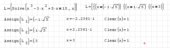

Working from the plugin, NonlinearSolvers build the T(z) RHS, call a symbolic calculation and then replace with a C# while all the [MATH eng]z[/MATH] variables with [MATH eng]x.0[/MATH], this is made to leave clean the canvas from internal variables (but maybe there is another way that I don't know or that I've missed)... Maxima probably crashes against the while cycle (but I'm not sure)

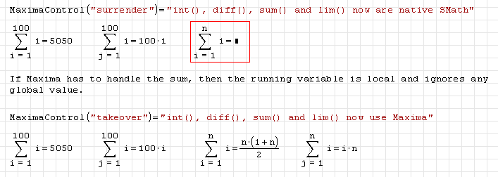

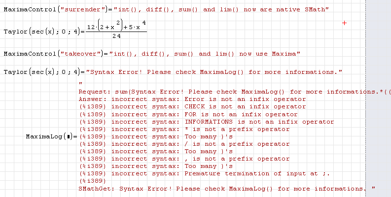

BUG/Dangerous feature:
Currently MaximaLog(), int(), diff(), lim() and sum() do not trigger start of a session!
Maxima must be started explicitly in order to take over the internal functions int(), diff(), lim() and sum().
Maxima session start can be triggered by one of
- any VALID MaximaControl() command (valid command strings are shown in the dynamic assistant)
- Maxima() with any argument accepted by SMath preprocessing
- one of the functions Solve(), LinSolve() or Algsys()
Make sure to re-calculate the document if you started the session by adding such a command into an active document.
This means that documents can behave differently depending on whether Maxima is running or not.
This is a bug/dangerous feature which we try to fix ASAP.
Meanwhile it is safe to stick to the recommendation in "Plugin Maxima.sm": Each document should at least do a cleanup at the beginning. This is to avoid interference between different open files in the same SMath instance and makes sure that Maxima is started. Use optimization> "None" or "symbolic" to see the "done".
MaximaControl("cleanup" )=done

Maxima now does not overwrite the functions diff(), lim(), int() and sum(), because of the problems sum() and diff() can cause. Thus, we hope that Maxima now won't interfere with existing sheets as long as you do not ask explicitly by MaximaControl("takeover" ).

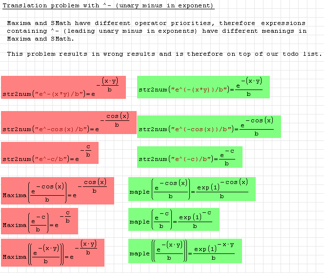

Serious translation problem with unary minus in exponents.
Currently, we see no easy way to mitigate that. The attached sheet demonstrates some alternative approaches but they all would involve more than just some regular expressions.
The reason is in the incompatible operator priority between Maxima and SMath, none of both sides can be blamed for that, except that the very low priority of unary minus in SMath is really unusual and is cause of other problems (try displaying -10°C).

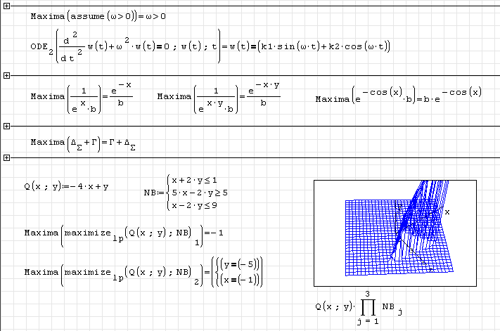

Plugin updated.
- Translation problem with unary minus in exponents solved (thanks to Leo Butler, one of the Maxima developers)
- Dedicated function ODE.2 for solving second order ODEs (wrapper for ode2())
- Bi-directional translation of greek uppercase letters
- Unidirectional (SMath to Maxima) translation of relational and boolean operators
- Improved error message forwarding

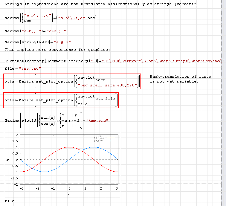

- Bidirectional transfer of string constants
-> more convenient plotting
-> Maxima string functions can be used
