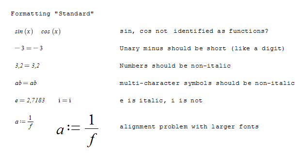

A short test showed the following issues (some of them might be matter of taste). I understand this is work in progress...
formatting.sm (5,5 КиБ) скачан 1671 раз(а).
EDIT: The functions are deliberately set to italic in "Standard". Thus this can be fixed using a custom style.

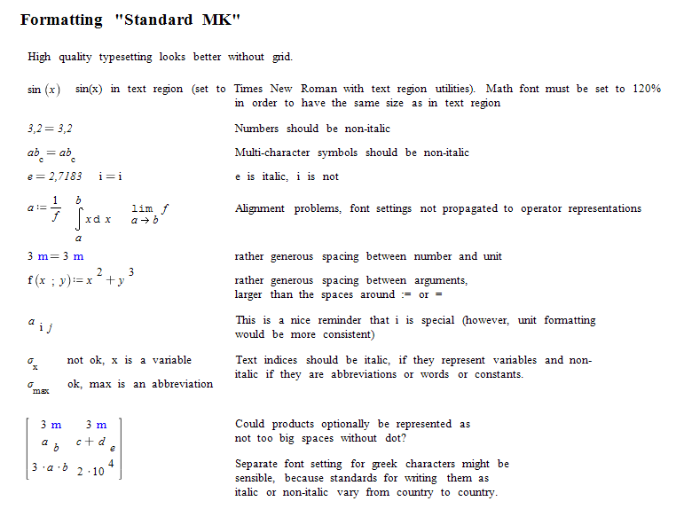

I felt encouraged to play around a bit. I wonder why the font in math regions must be scaled to 120% to result in the same font size as in text regions of the same font.
Perhaps we are entering an era, where people become more picky about appearance issues of SMath sheets. The monospaced text regions become inappropriate now...

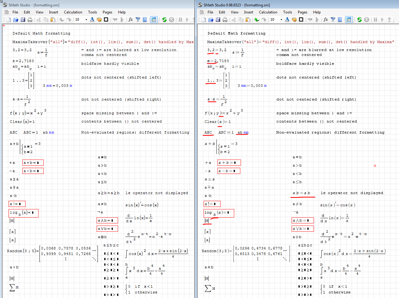

#12 Опубликовано: 10.11.2017 08:27:07
I encountered the following visualization problem in the use of vectorize (equations formatting: Default, Old Style, Standard)
[albumimg]1464[/albumimg]
Seems that the boolean operator "greater than or equal to" is not drawn, unrelated to vectorize
I experience some horizontal misalignments (caret position, empty placeholders, ...), I am the only one?
frapuano 10.11.2017 10:02:00, sergio 10.11.2017 08:42:00

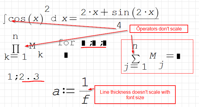

Some issues with higher font sizes:
#18 Опубликовано: 11.11.2017 01:20:17

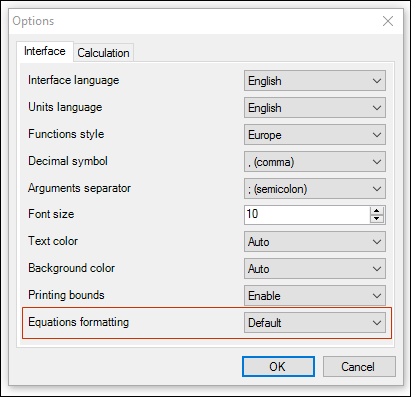

Ive experienced some strange font scaling issues in in the two latest builds (using the latest right now). As I change the font size using either the settings menu or the toolbar option, the effect seems inversed and interacting with each other. Furthermore, they dont display the correct font scale value. As I press enter in the first image, one expects the typeface to get larger (from 7 to 14), yet the inverse happens. As I open the settings again, it displays a 10, and thus does not remember the latest changes. This effect doesnt appear to be linear, although its hard to notice when scaling.
The problem is not specific to any particular file, but occurs whenever I change font sizes, and persists through restart/new file.
#19 Опубликовано: 11.11.2017 06:07:36
The font settings under Tools> Options shouldn't have immediate effect at all. AFAIK this is just the default setting for new documents and can be overridden at any time by the toolbar entry for font size.
I'd recommend to clearly indicate the scope of the options in the dialog.
