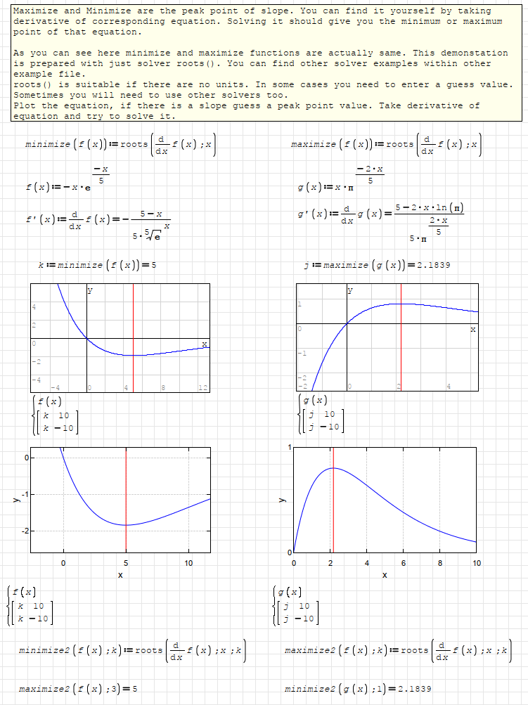

You can write your own functions.
maximize and minimize are peak points of slope.
Take derivative of equation, solve it.
Check the examples below.
maximize_minimize.sm (16,48 КиБ) скачан 1215 раз(а).
maximize_minimize with different solvers.sm (28,5 КиБ) скачан 1215 раз(а).
Unfortunately, this does not work with my function, because it is more complex than yours.

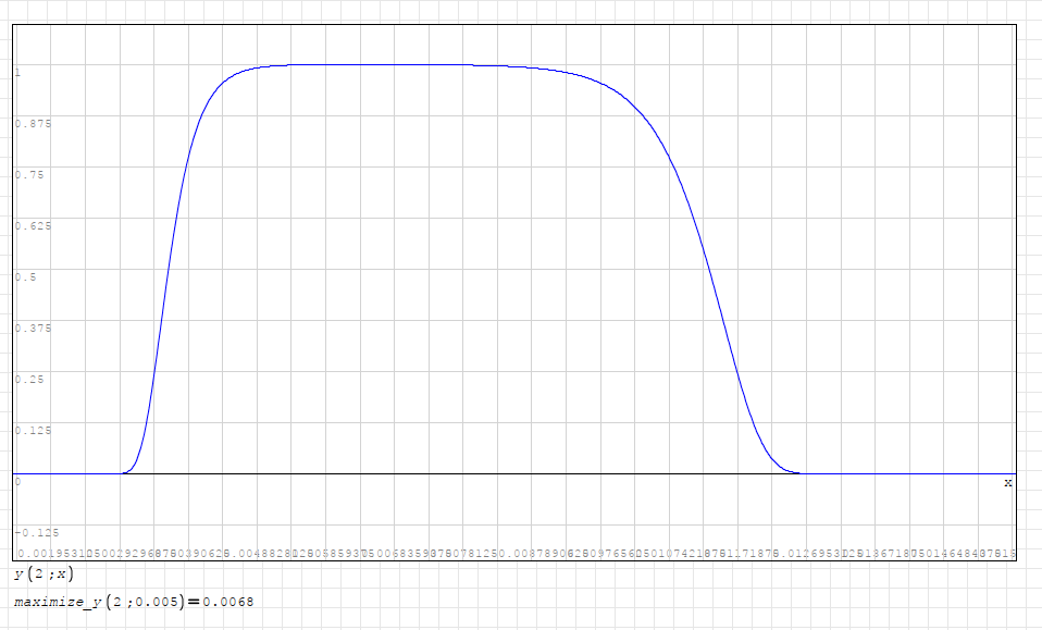

Thanks for your feedback , but I need to calculate maximize from the function K(x),
not from y(j, x).

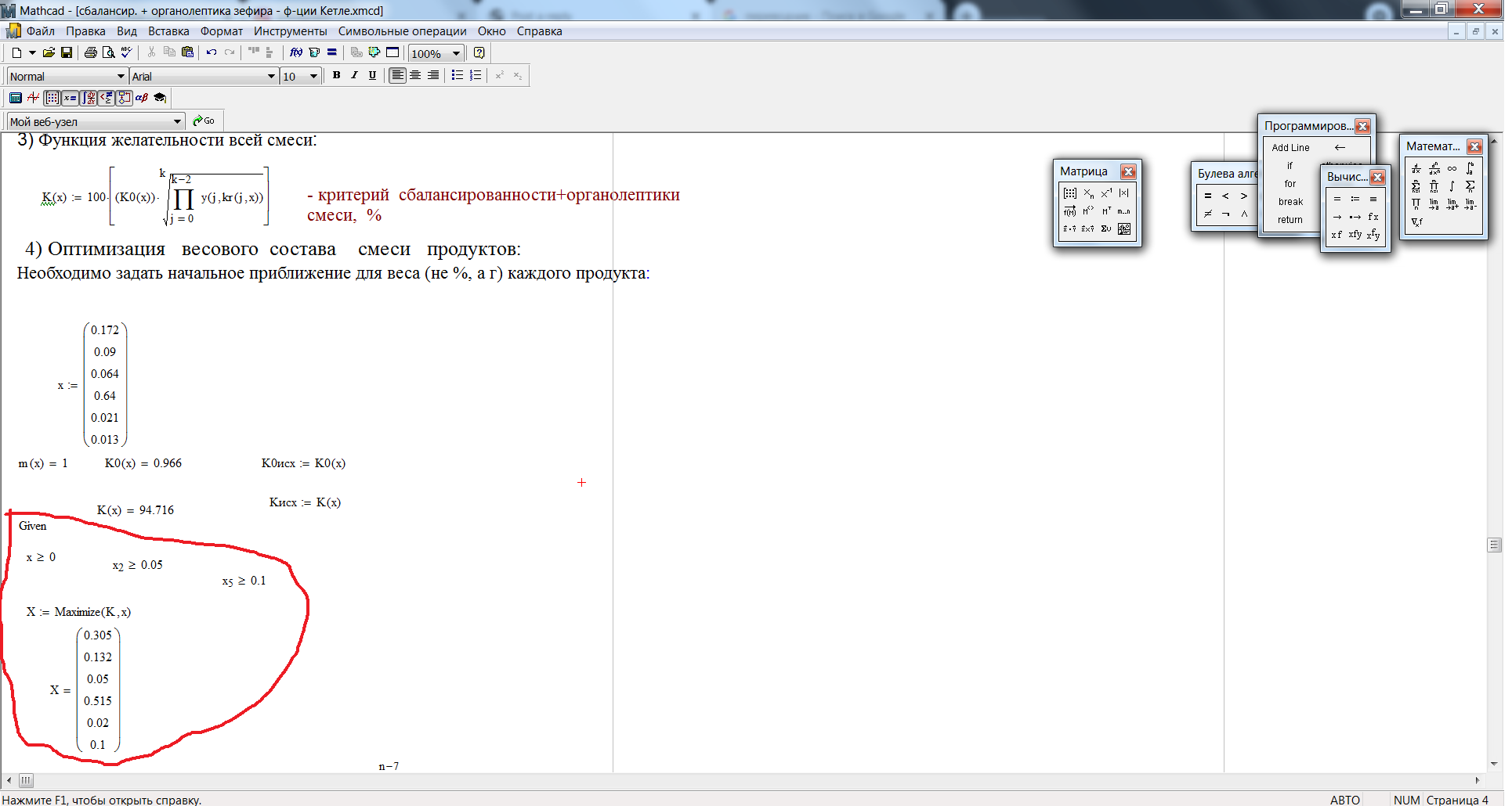

Check this pdf Mathcad file:
Mathcad - sbalansir. + organoleptika zefira - f-cii Ketle.pdf (245,08 КиБ) скачан 723 раз(а).
After the function K (x), the vector x is given as the initial approximation
and after that the Given and Miximize functions are used for the K(x) function.
I need to get vector X in Smath.

#10 Опубликовано: 30.04.2021 06:31:24
Denis
Denis
0 сообщений из 14 понравились пользователям.
Graphs are doctored and more, but can't sanity more
Cheers ...Jean
diplomnayaRabota.sm (45,97 КиБ) скачан 1159 раз(а).
Thanks for your corrections , but the main question was how to get this vector X without the Given and Maximize functions,
because it's obtained from these functions: "X: = Maximize (K, x) ?
The bloc solver Given ... Find, Minerr, Maximize, Minimize
is Mathsoft proprietary specific to Mathcad. No such equivalent Smath.
Given/Minerr for fitting model function to data set is done otherwise
in Smath via Conjugate Gradient ... same or even better.
If there is another way of doing in Smath, expect Designers to help.
Sorry Collab, can't help directly on that ... Jean.
I tried to do this for a simple function through the "roots" function, and in the end I found the maximum,
finding the maximum for a simple function.sm (12,91 КиБ) скачан 1215 раз(а).
but there are no ideas how to do this for K (X), since it depends on 6 arguments of the vector x.
Is it possible to somehow implement the same algorithm in my task?
