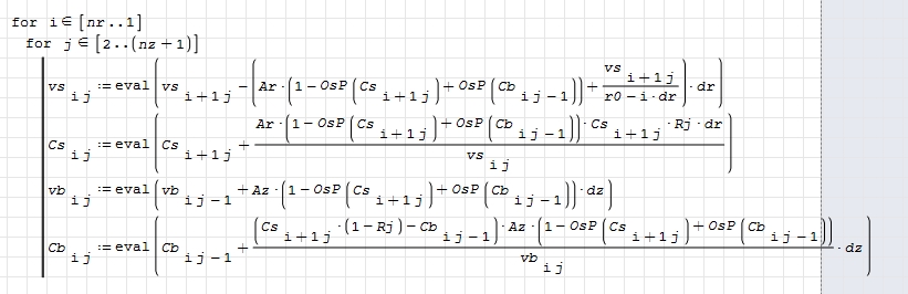

Thanks a lot. It appears, eval is a very important function. I tried to eval every dimensionless variables and functions, such as OsP, dr before the loop. And it took some time finished the calculation. Still, takes ages long comparing to mathcad.

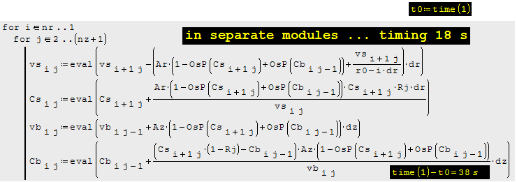

In separate mode my 1.66 GHz Win 7 calculates the 4 matrices in 18 seconds.

I have nz and nr both 200. It took about 10minutes in Smath to finish the whole program.
It appears the for loop takes a lot of time. If you can replace for loop with a matrix operator, such as SUM operator, it calculates faster. Personal experience, I don't know why.

1. Separate modules in the attached... Two complain, but produce.
2. Try matrix operator matrix(3,4) to see if it can help you wrt the project.
3. I know no other way to construct your 4 matrices.
4. From the matrices, your can select any col/row
... you can sub-range any part ... you can unwrap in single vector.
Cheers ... Jean.
