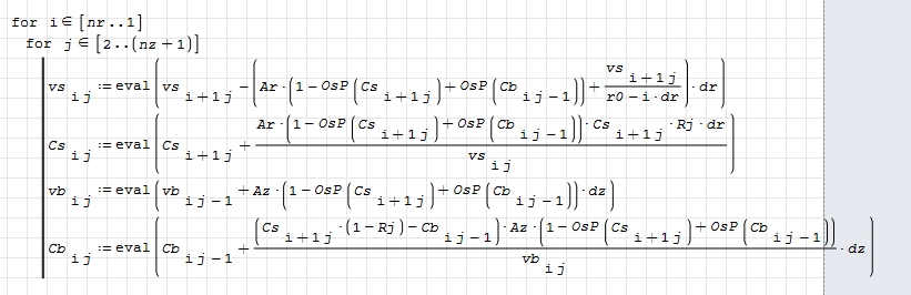

and can speed up a little the calculation using eval for each line:
WroteAny trick to solve this ?

WroteHi. Two issues. First, you use two percent symbols, but forgot to put them as units: try to add them as '%, and they goes in blue color.
For the second, your observation now it's correct:WroteI suspect the variables stored the expression instead of results, which could take too much memory?
Thanks a lot. It appears, eval is a very important function. I tried to eval every dimensionless variables and functions, such as OsP, dr before the loop. And it took some time finished the calculation. Still, takes ages long comparing to mathcad.

WroteStill, takes ages long comparing to Mathcad.
Mathcad is a semi-compiled CAS.
In separate mode my 1.66 GHz Win 7 calculates the 4 matrices in 18 seconds.
