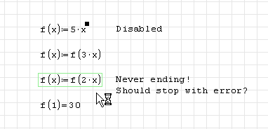

#6 Опубликовано: 30.09.2010 03:10:33
Hello Andrey,
Sorry for being persistent, but I think I was not precise enough. The previous calculation will work in SMath - there was not a problem.
But, try this:
The problem is that this will never stop, until we "Interrupt processing". My question was - Should it be left this way or should it be stopped by SMath.
#7 Опубликовано: 30.09.2010 08:52:55
Группа: Super Administrator
This is also fixed. Now SMath Studio understands that it is not good practice to repeat substitution of the already substituted functions with the same names So one will not see infinite loops in such cases anymore.
