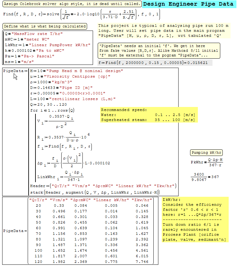

By same token of "Pipe Data", Colebrook Moody has been refactored.
Observe carefully the code to make the 'solve block' survive by
introducing it within a program structure. In this implicit solve,
the block needs an [one] initial value. Same code structure as
it was discovered in Mathcad 8/11 [undocumented].
A splendid piece of Engineering work for publishing and documenting
the project, tracable for the client's archive.
Inst_Colebrook MOODY.sm (16,74 КиБ) скачан 1546 раз(а).
Inst_Colebrook Pipe Data.sm (24,35 КиБ) скачан 1501 раз(а).

... typos, updated, on-fly calculator added.
JeanInst_Colebrook Pipe Data.sm (60,85 КиБ) скачан 1480 раз(а).

#6 Опубликовано: 23.04.2016 09:43:20
Yes. kWh = kW*hr. This is unit of energy. Energy is integral of power by time, i.e. mean power multiplied by time. Power is measuted in kiloWatts, time in hours.
What you say is right, but not for design Engineer.
The Engineer wants to know the "POWER RATING" of the
motor to push Q[T/hr] via the pump it activates.
That's what the "Pipe Data" answers for those in that stuff.
Just introduce the 'r' efficiency factor from the supplier
of the 'MotorPump'.
