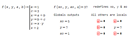

Hi. Maybe this is what you are looking for: "Defining a function as f(x) := 1*(| ... ) make all variables in line(...) as globals." from here.
Also, you can use eval(line(...)).
#3 Опубликовано: 25.07.2023 21:50:31
Also, wrapping the block in eval() makes all variables global. This doesn't even require assignment or display operators.
In fact, you also could use other structures like lists { or matrices [] to collect definitions. Yet, only the line operator warrants a certain sequence of execution.

#8 Опубликовано: 25.07.2023 23:36:58
... I assume that above the maths you have shown in your post, you have separately defined xo:=5, y:=7 etc. ...
Hi. Nope. What you see is the entire worksheet, there are not hidden code there, sorry for not having attached it, for laziness. xo, y & ao turns global only after calling f(xo,y,ao). Before they could have some value or be undefined.
That ability to modify the values of the arguments passed to a function, whether or not they are defined, is unique to SMath and is not present in maple, mathematica or matlab, at least not in a simple way.
additional result.sm (6,99 КиБ) скачан 1361 раз(а).

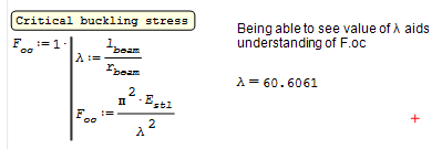

#11 Опубликовано: 26.07.2023 10:33:32
I am trying to think simple.
Maybe sys() is what you looking for.

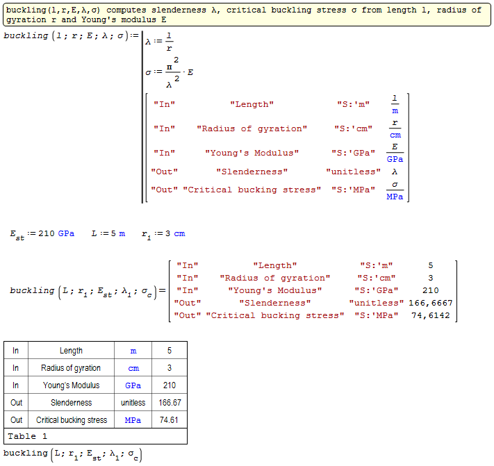

Casting the computations into block functions with no reference to context variables from inside removes any restrictions on variable names in the sheet. With a proper description such functions become self-documenting. This way you can create portable collections of such functions (and store them as snippets).
Blatt22.sm (5,76 КиБ) скачан 1400 раз(а).
Oscar Campo 26.07.2023 18:58:00, NDTM Amarasekera 26.07.2023 22:51:00, Alvaro 27.07.2023 00:04:00

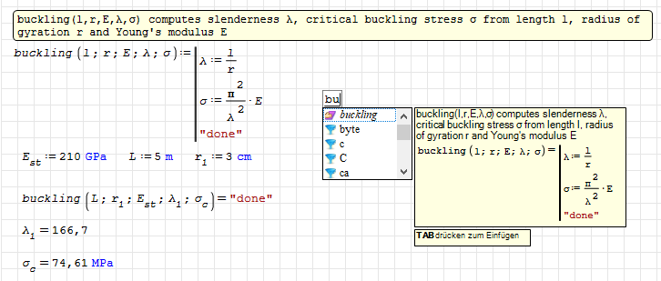

Hi. Pushing Martin's solution one little step further.
Blatt22 ver 2.sm (18,86 КиБ) скачан 1403 раз(а).
Blatt22 ver 2.pdf (82,91 КиБ) скачан 849 раз(а).

Here is a easy way to get a summary for procedural implementations of algorithms. You just insert a table region, write your function to the placeholder and do some format adjustments. In the example I just switched from fixed to variable width of table columns and set the font to arial.
Unfortunately, the decimal separator setting is not respected.
This procedure has full control over units in results display and can be extended to alvaros generalized approach (with then input and output flags being dynamic).
Blatt22.sm (12,98 КиБ) скачан 1410 раз(а).
