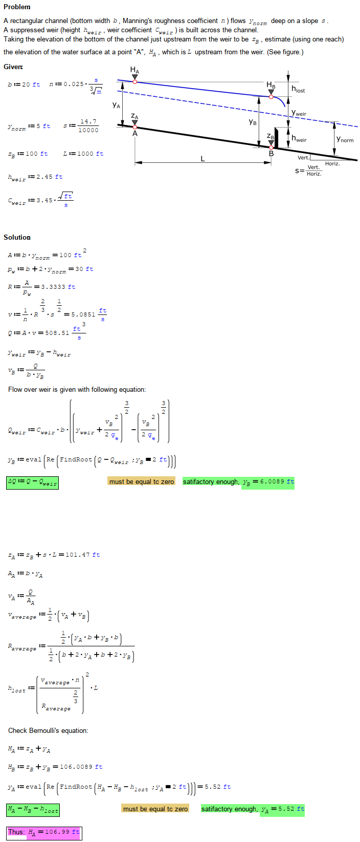

I'm trying to make a SMath worksheet for calculating flow over weir. The problem is iterative, i.e. when you calculate it "by hand" you have to estimate some values and then check if your estimation is close enough.
Here is my workbook:
suppressed_weir.sm (79,98 КиБ) скачан 1185 раз(а).
suppressed_weir.pdf (365,79 КиБ) скачан 790 раз(а).
I tried to solve this problem by using "solve (2)" function, but I'm obviously doing something wrong...
Could anyone help me with this?
Cheers,
Sandro

Hope this is enough for you.
Solve can't work with units.
Sometimes it just refuses even without units.
Use roots(), FindRoot(), al_nleqsolve() if it fails.
In this order generally.
Regards.
suppressed_weir1.sm (82,41 КиБ) скачан 1182 раз(а).

Thank you, overlord, that works exactly as I wanted!
